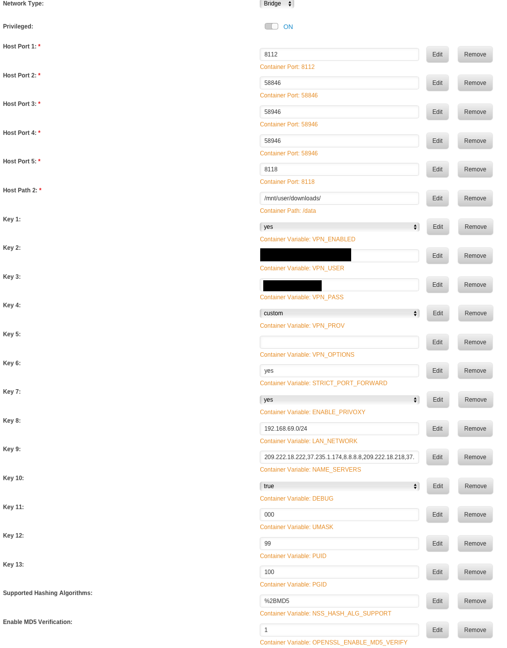

On 16/08/2017 at 1:32 PM, tunafish said:
I also have this error trying to connect to PureVPN using their supplied linux .ovpn files.
They recommend using the following additional environment variables, but I can't get the first one to pass through to the container correctly because the plus sign "+" is being stripped. I tried escaping it "\" and wrapping it in single quotes to no avail.
NSS_HASH_ALG_SUPPORT=+MD5
OPENSSL_ENABLE_MD5_VERIFY=1
https://support.purevpn.com/openvpn-connection-issue-on-fedora
Any ideas?
Not sure if you've had an answer to this, but I couldn't find one…
Replace the + with %2B — it's being passed through a function like PHP's urldecode() at some point.
Where are you setting these? I've tried putting these settings in VPN_OPTIONS, and it falls over, complaining about invalid options to --auth-user-pass.
I've tried adding a couple of container variables, as below, and it doesn't enable MD5 verification, as the log shows.
Could somebody please explain how I can set this image up to connect to PureVPN? The only solution I've seen suggested is "get PureVPN to upgrade their certificates", which would be ideal, but also not likely to happen any time soon — and in the meantime, I have a subscription I can't use with unRAID…
Update: I've also tried removing the two variables I've added, and adding
--setenv NSS_HASH_ALG_SUPPORT '%2BMD5' --setenv OPENSSL_ENABLE_MD5_VERIFY '1'
in VPN_OPTIONS, but this just results in a command line ending in
--auth-user-pass credentials.conf '--setenv NSS_HASH_ALG_SUPPORT '+MD5' --setenv OPENSSL_ENABLE_MD5_VERIFY '1''
which doesn't work either. Surely there must be a way to add these environment variables?
log.txt
Further update: OK, it seems that the easy solution is to raise a ticket with PureVPN and ask them for a more up-to-date cert. You'll then need to edit the .ovpn file to change the server address to one that supports the new cert (they should provide a list of these in their reply). At least I'm up and running now…
Edited by ElectricBadger
added info

I also made sure the docker had internet connectivity (when the vpn was disabled).
Here is my log file.
Any help is appreciated.
supervisord.txt
i would say you have either a very slow internet connection, unstable internet connection, or isp blocking going on, looks like TLS authentication is simply timing out:-
2017-11-25 17:01:47,828 DEBG 'start-script' stdout output:
Sat Nov 25 17:01:47 2017 TLS Error: TLS key negotiation failed to occur within 60 seconds (check your network connectivity)
Sat Nov 25 17:01:47 2017 TLS Error: TLS handshake failed
2017-11-25 17:01:47,829 DEBG 'start-script' stdout output:
Sat Nov 25 17:01:47 2017 SIGHUP[soft,tls-error] received, process restarting
you could try another endpoint such as nl.privateinternetaccess.com
