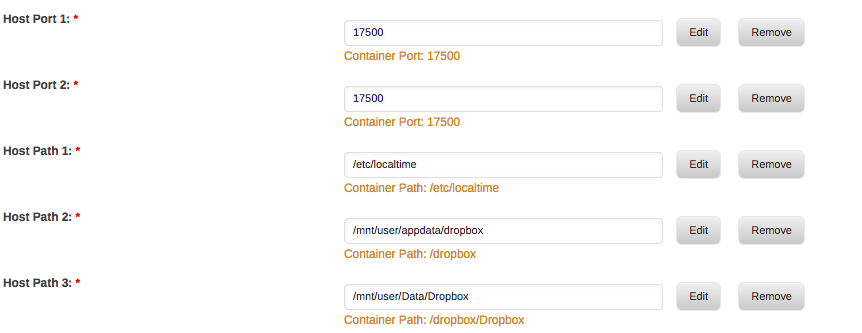

I am having a heck of a time getting this thing going.  I am getting the dreaded warning: tornado error.  Maybe someone could explain permissions to me, as I thought I understood them, but I guess not.
1)  I always login as root to unraid both in Terminal and Gui.  I know this is frowned upon in the Linux world, but I thought that was the only way to do it in Unraid.
2)  All my shares were setup then as root
3)  All my dockers were also setup as root.
Did I completely mess this up?
Why would I need to set Dropbox userid if I never set it up under another user?
This was all done on V6.2, so I never needed to run new permissions, but I did anyway and it still is not working.
Thanks for any help!

Can you post the volume mappings you've set for Dropbox docker, as well the directory listing for the appdata dir and the Dropbox data dir?

As you can see my Dropbox files are under another share.  Is that an issue or can it stay there?
Thanks
Yes, well the problem is that your data is owned by the user matt and not nobody.
This tells me your shares are secured and that you created a user matt for access.
Separate appdata and data directories are fine and is the only way its going to work if you want to access the Dropbox directory from the LAN.
Post a screenshot of the configuration for Dropbox docker. (hmm seems I forgot to update the template to 6.2)
Refer to the previous posts on how to setup the Dropbox user id to match that of your user matt
Read and make sure you understand it. Then nuke all the dropbox folders and start over.
