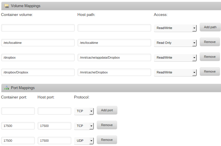

Add the docker and configure the folders:
refer to attachment: Container Mounts.png
Then check the docker container logs for a link to copy and paste to link your dropbox container.
