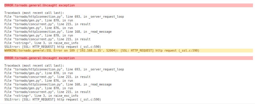

Hi Ken-ji, I tried to look trhrough this whole thread but I it hasnt provided a solution.
Should I be concerned with lots and lots of these warnings?
WARNING:tornado.access:404 HEAD /blocks/34712932/Dht4YrZYh006B4yGlRRpf2UsJ82yu0mfWsYT92QdF-o (172.17.0.1) 5.57ms
I've done the most basic vanilla install possible, no mucking around with settings etc. Dropbox share "Dropbox" is set to not use the cache.
Seem to download everything ok, but files places directly in the dropbox share folder are not uploaded...
Thanks in advance

Hi Ken-Ji,
I am a new user and I unfortunately (or fortunately if you are looking for debug cases) have seen both the "tornado access" issue that Zangief sees and the loss of Dropbox link issue.
How my install and issues transpired:
I installed Dropbox Container last week and successfully download the contents of my Dropbox after linking the container (I believe it was March 8th)
I restarted Unraid several times for various reasons and noticed that Dropbox syncing stopped.
I re-linked Dropbox again this morning (used the same computer ID according to Dropbox logs) -> This seems to have fixed the file syncing issue
Now I see the Tornado warnings.
One point to note:  Dropbox logs have an info button.  They say that the app version that I attached to last wed is different that today. Could that be the source of the warnings?
Wed was Ver 20.4.19 (No warnings)
Today was Ver 21.4.25 (Tornado Warnings)
Thank you for writing and supporting such a great container!

Well, because Dropbox app needs to be updated against their own schdule, I've made sure the docker can upgrade itself as it wants. If it fails to upgrade for a while, eventually Dropbox will complain and refuse to sync.
I'm not sure why you guys are getting the tornado access issues. I'm fairly sure it has to do with permissions and the fact that dropbox needs to be able to access the files as a specific user, which by default is nobody.
