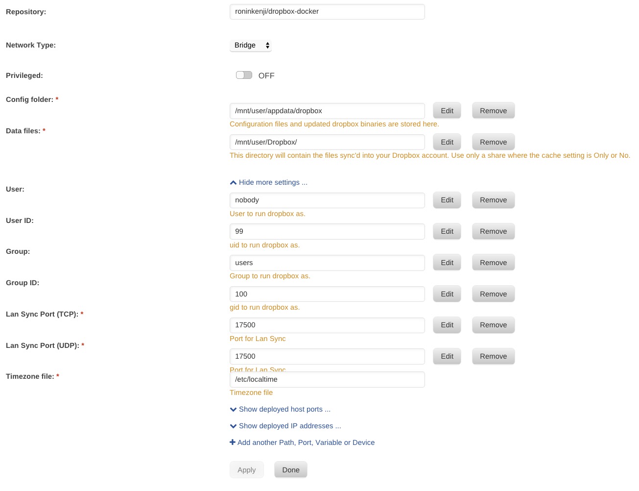

Using Dropbox Docker container [up to date version-while posting this]
Noticing many weird behaviours:
  • Worst of all: Share named "Dropbox" cannot be shared, is not published and not accessible by user. Shows up only if I connect as Guest but when clicking to list files connecting with AFP or SMB show and error."The operation can’t be completed because the original item for “Dropbox” can’t be found." Browsing with Krusader I can see all files synced, my own-created shares are working fine.
  • Clicking on Port Mappings row "17500/tcp  192.168.1.201:17500" can't reach any site/page, not sure if this is indented for clicking...
  • There is not "dumbo-mode" to login and start Dropbox from container, I've luckily clicked on Log "Up 31 minutes" and noticed a looping message about clicking on a link pointing to Dropbox.com...
  • Checking with Krusader seems that permission are not passed correctly when set in Shares>Share Settings>AFP...
Enclosing screenshot of Container page, pretty much default settings.
Thanks for any ideas you Gang would like to share here.
Mark
[unRaid Server Plus 6.4.0]
Well the default of the Docker is to run as the user nobody which has all the necessary permissions to be accessible by guest/(insecure share)
I think the missing step is to actually define the Dropbox share user the Shares TAB of the unRAID Web UI
Because if you didn't define it there, it will pickup/assume some settings that might not make any sense to your configuration (public share, etc)
Do take note that by default a user share with a cache drive is a recipe for data loss, since any changes to your Dropbox files will result in the mover running at some point causing Dropbox to delete the underlying files. tl;dr the Dropbox share should be a cache-only or share-only. Do not try any of the other settings.
The app running is the default one by Dropbox and has no "dumbo-mode" UI's .
There's no site/page either - 17500 is needed for LAN syncing - Dropbox will happily send/receive updates from any of your Laptops/Desktops
