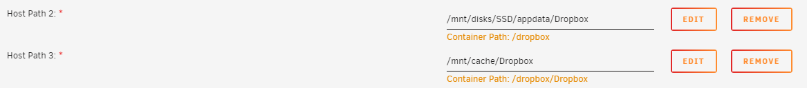

The path of Data of Dropbox is in array: /mnt/user/Dropbox/Dropbox
The folder Dropbox is created by deamon of Dropbox service in docker..
Do you have, author, any advice for me for runing Dropbox at UnRaid?
Many thanks for any advice...
I think the problem is that the data directory is in the array as there have been known issues with sqlite and the array user shares filesystem. This issue seems to be fixed in the the current RCs.
For the time being you can put the docker data in /mnt/cache/Dropbox via the settings and editing the Container Path: /dropbox/Dropbox

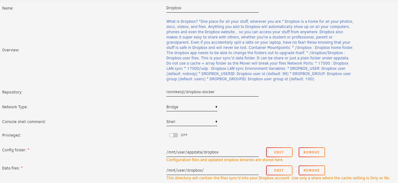

You might want to show the Host path settings that you have so we can see why yours became /mnt/user/Dropbxox/Dropbox
If you do this *changing the location of the Dropbox files*, make sure to either start fresh with empty Dropbox and appdata directories, or move the files in as Dropbiox might decide you emptied your folder and proceed to nuke all your files.
Edited by ken-ji
Ok. I tried set Host Path 3 to /mnt/cache/Dropbox. The path /mnt/cache/Dropbox was created. But in log I see same error: "Couldn't start Dropbox.
This is usually because of a permissions error. Storing your home folder on a network share can also cause an error."
Any other idea what can I try change?
Edited by Ropo
The problem was in Host Path 2. I set this path to /mnt/cache/appdata/dropbox. But I see new message in log: "[ALERT]: So your files continue to sync, sign in to your Dropbox account and move Dropbox to a supported file system."
I have the path Host Path 3 set to /mnt/user/Dropbox/Dropbox. This Dropbox service not support XFS file system in UnRaid array?
The entire /mnt/user is a FUSE filesystem called shfs - which is what Unraid uses to merge all the disks together into a single virtual filesystem.
Dropbox is being anal by just checking the fs in use and rejecting "unsupported" ones out of hand. Also if Dropbox wasn't being anal, storing your Dropbox files on the array would cause issues unless use cache disk is turned off, else watch Dropbox delete your files when the mover kicks in.
The workaround for this is to locate the Dropbox files on a specific disk ie /mnt/disk1/Dropbox or /mnt/cache/Dropbox (like I do).
Another workaround, if you must store it on the array, is to create a loopback disk image on the array and format it ext4, then mount it ie /mnt/disks/Dropbox then point Dropbox there.
Ok. I understand it now. I set Dropbox folder to /mnt/disk4/Dropbox anf now Dropbox in container is working.

Edited by CyberMew
@CyberMew Hey, I don't have dropbox for business and have never tried the container with such an account.
I will say the error logs seems like your container seems to be failing in connecting to the Dropbox servers. Diud you try starting the container against a new and empty appdata folder as well as the Dropbox folder?
Hi
I am getting this error
From this same page on this thread:
So I'd just like to point out for anyone else starting from scratch this is the way to fix it. I had self resolved but couldn't update as I was post limited! But thanks for the help!
