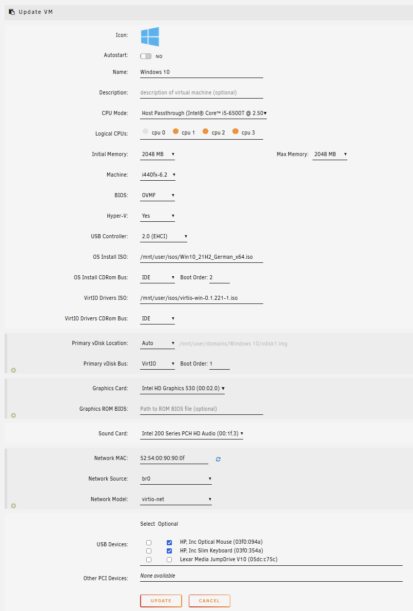

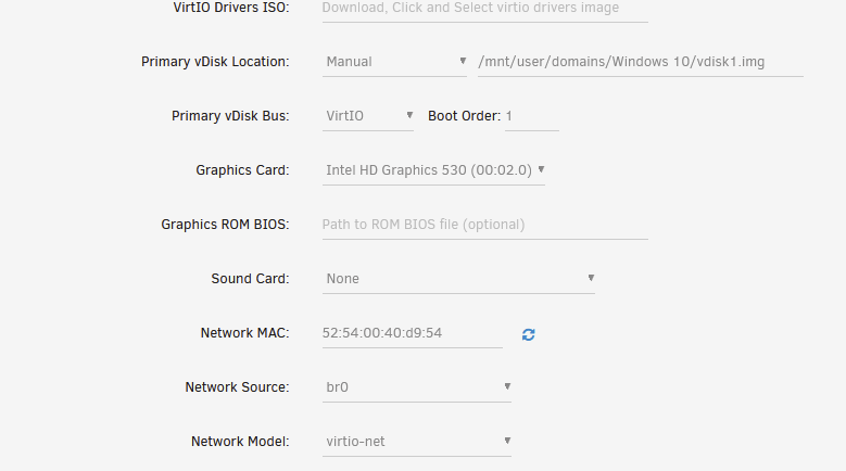

Hi there
I hope this is the right topic (and I am an noob, so sorry, if there is a solution, but I was to stupid to understand it). I have bought an used "HP ProDesk 600 G3 Mini DM Intel Core i5-6500T" an wanted to run Unraid on it with a Windows 10 VM, which will be my daily driver.

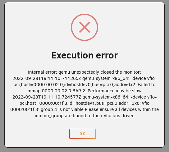

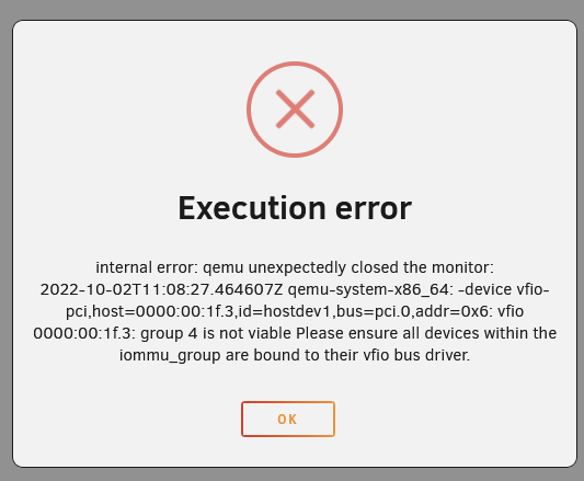

Unfortunately I am getting error messages, when I try to launch the VM with the graphics passthrough.
Here is what I've done so far:
* Activated Legacy Mode in BIOS in order to be able to start unraid
* Activated this checkbox and rebooted the server
* Created a Windows 10 VM with following settings
* Received this error message
* Those settings didn't work so i changed the Grapics card to VNC, and installed Windows 10 (is now working fine, but in VNC).
My main goal is to use the DP output on the PC in order to work with my regular monitor.
I've seen this post, but i don't know if this is something, what could/should help (Edit: checked it out with the developer. It might be possible with additional hardware, but there might be several issues. So a "natural" passthrough from the pc's DP to the monitor would be a more stable solution):
Thanks for any help!
Cheers!
Edited by Doublemyst
Added edit

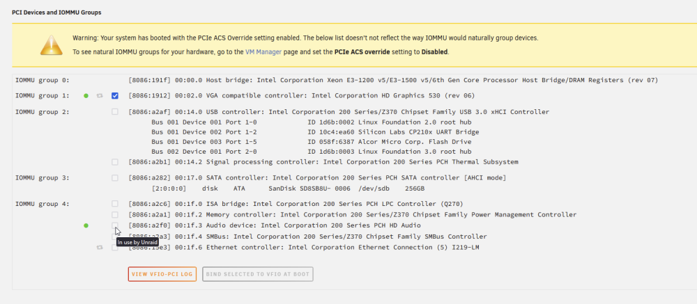

A small update.
I've done modifications as suggested by @salora and modified my Syslinux configuration and even added allow unsafe interrupts and created a new VM using SeaBIOS:
kernel /bzimage
append pcie_acs_override=downstream,multifunction vfio-pci.ids=8086:a2f0 modprobe.blacklist=i2c_i801,i2c_smbussnd_hda_intel video=efifb:off,vesafb:off vfio_iommu_type1.allow_unsafe_interrupts=1 initrd=/bzroot
Where "8086:a2f0" is my audio card:
But had no luck, as I got this error message
Which indicates, that the audio device is still somehow binded to unraid.

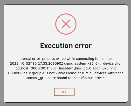

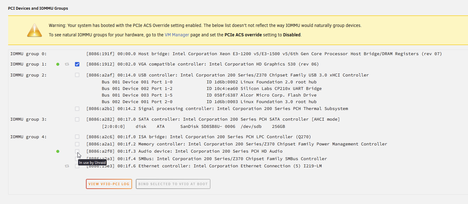

Then I tried this configuration:
After checking this config for modprobe.blacklist
and seeing someone using this i915 in his configuration:
kernel /bzimage
append pcie_acs_override=downstream,multifunction vfio-pci.ids=8086:a2f0 modprobe.blacklist=i915,snd_hda_intel,snd_hda_codec_hdmi video=efifb:off,vesafb:off initrd=/bzroot
But this didn't help neither..
When I disable the audio card, the VM is starting, but I have no video output.
The reason I think is the missing ROM Bios, but I didn't manage to find one for intel hd graphics 530.. Found drivers and several roms for differend intel hd graphic cards, but not the 530.. Maybe someone has one laying around?
On techpowerup those are the processors, but I couldn't find the bios files:
https://www.techpowerup.com/gpu-specs/hd-graphics-530.c2789
https://www.techpowerup.com/cpu-specs/core-i5-6500.c1829 my processor is i5-6500T, but i think those are very similar.
Anyone any suggestions?
Infos added

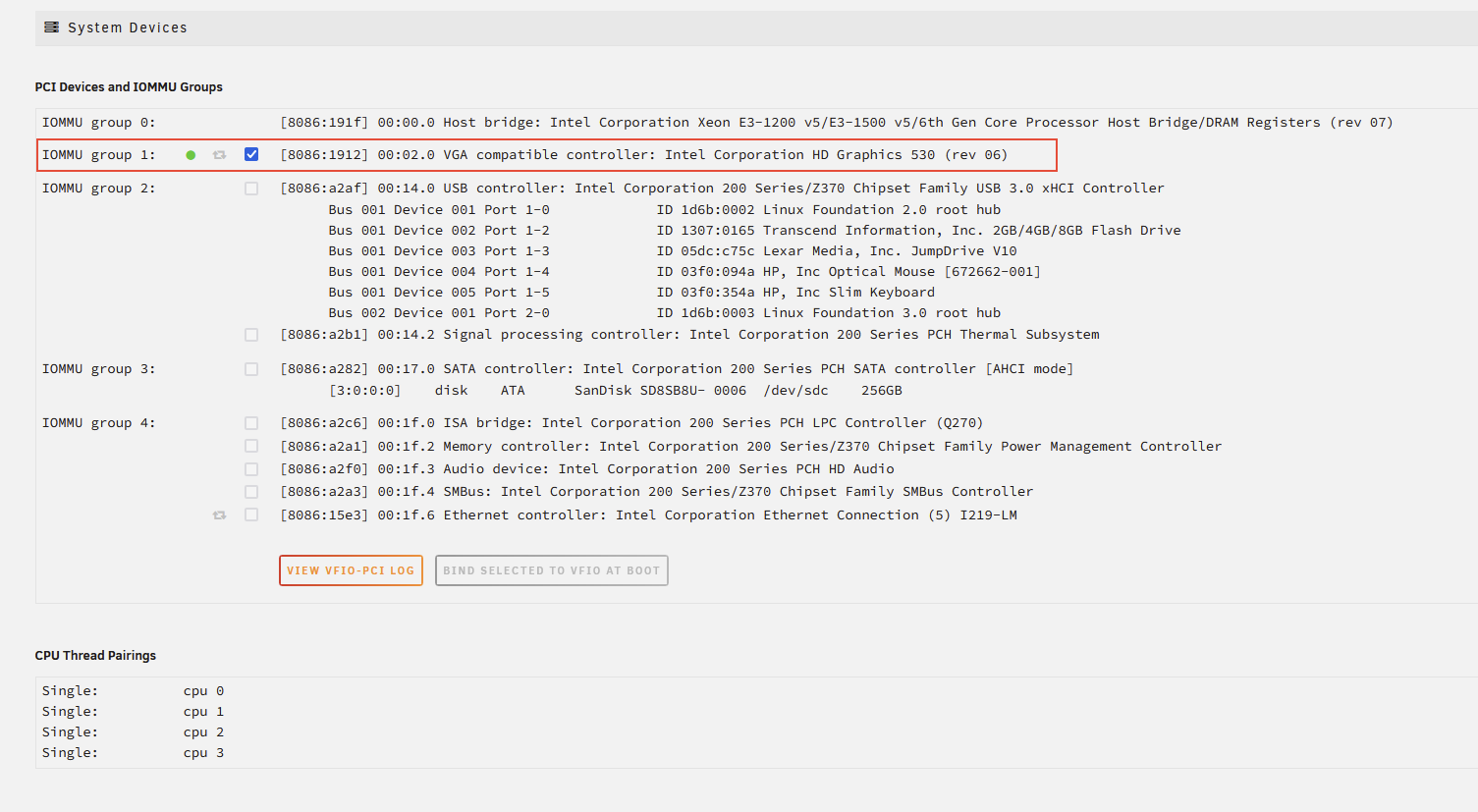

IOMMU:
Mine look like these:
To be able to passthrough the audio device you have to make sure that none of the devices in this group is used by unraid.
I actually had one of my two ethernet controllers listed there aswell which was used by unraid. After I switched to the second eth controller in the network settings the group was free to use. I also disabled the first eth controller in the BIOS (that's why it's not listed in group 10 anymore).

Thanks for the write up Marv, I followed it exactly however It did not solve the error Im having. Its not entirely the same thing, But I have an UHD 750 and when running the VM, I get this:
2023-01-15T22:59:11.306752Z qemu-system-x86_64: -device {"driver":"vfio-pci","host":"0000:00:02.0","id":"hostdev0","bus":"pci.0","addr":"0x2"}: IGD device 0000:00:02.0 has no ROM, legacy mode disabled
2023-01-15T22:59:11.724838Z qemu-system-x86_64: vfio-pci: Cannot read device rom at 0000:00:02.0
Device option ROM contents are probably invalid (check dmesg).
Skip option ROM probe with rombar=0, or load from file with romfile=
Any ideas as to why
Mine looks very similar here. This shouldn't be the problem.
2023-01-16T14:26:50.071283Z qemu-system-x86_64: -device {"driver":"vfio-pci","host":"0000:00:02.0","id":"hostdev0","bus":"pci.0","addr":"0x2"}: IGD device 0000:00:02.0 has no ROM, legacy mode disabled
2023-01-16T14:26:50.195651Z qemu-system-x86_64: vfio: Cannot reset device 0000:00:1f.3, no available reset mechanism.
2023-01-16T14:26:50.195736Z qemu-system-x86_64: vfio: Cannot reset device 0000:00:1f.3, no available reset mechanism.
2023-01-16T14:26:50.769928Z qemu-system-x86_64: vfio-pci: Cannot read device rom at 0000:00:02.0
