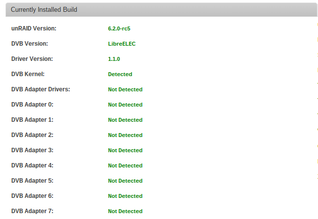

Is there something wrong with RC5 ?
After updating to this build, my tuner card no longer works.
My card is a Hauppauge WinTV HVR400.
Shows up in lcpci as: Multimedia video controller: Conexant Systems, Inc. CX23887/8 PCIe Broadcast Audio and Video Decoder with 3D Comb (rev 04)
It usually uses the cx23885 driver, but trying to load this driver results in: modprobe: FATAL: Module cx23885 not found in directory /lib/modules/4.4.19-unRAID

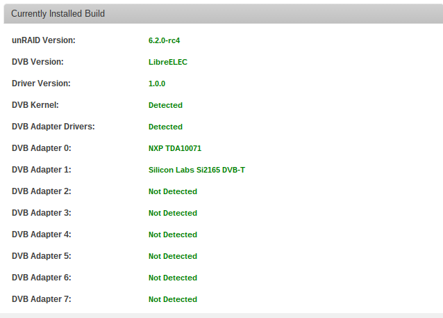

Attached is what is seen from the admin panel both before and after update
lsmod from rc4
root@tower:~# lsmod | grep cx
cx23885               137839  1
altera_ci               7092  1 cx23885
tda18271               32424  3 cx23885
altera_stapl           20796  1 cx23885
videobuf2_dvb           3622  1 cx23885
m88ds3103              11175  1 cx23885
snd_pcm                64936  1 cx23885
snd                    37711  3 cx23885,snd_timer,snd_pcm
tveeprom               13305  1 cx23885
cx2341x                14109  1 cx23885
videobuf2_dma_sg        6516  1 cx23885
dvb_core               72173  4 cx23885,altera_ci,m88ds3103,videobuf2_dvb
rc_core                14707  1 cx23885
videobuf2_v4l2         13519  2 cx23885,videobuf2_dvb
videobuf2_core         21807  3 cx23885,videobuf2_v4l2,videobuf2_dvb
v4l2_common             2841  4 cx2341x,cx23885,tuner,videobuf2_v4l2
videodev              100108  5 cx2341x,cx23885,tuner,v4l2_common,videobuf2_v4l2
Recompiled, try this version.  Download bzroot, bzimage & bzroot-gui and copy them across to your USB drive.  Let me know if it works.
Thanks CHMBM, that build has got it working again. Simple Kernel Misconfiguration?
lsmod from rc4
cx23885               137839  1
Hey CHBMB, It seems we have this again on 6.2-Stable:
root@tower:/lib/modules/4.4.19-unRAID/kernel/drivers/media# modprobe cx23885
Dunno what went wrong there, undoubtedly user error....  :-[
I've built again and re-uploading them.  Should be finished in about ten minutes....
