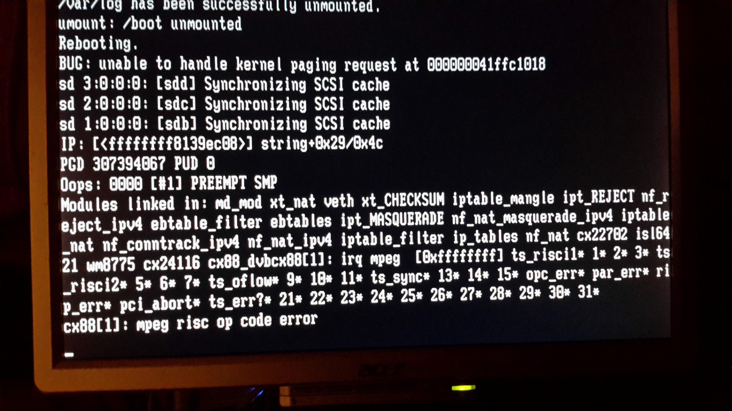

Hi, I installed the RC6 Dvb version and whenever I reboot the system it hangs and I have to press the reset button. It does not start a parity check from an unclean shutdown.
I have 2 Hauppauge DVB cards (Nova S2 and a 4000 I think) also a Cinergy DVB-T dual tuner) all the cards work fine in TVheadend but I get this error on reboot or shutdown.
Thanks

I have absolutely no idea.  Does this happen if you remove either of the DVB cards or both the DVB cards?
I will try that next, probably tomorrow or at the weekend. The Hauppauge cards are PCI, I was using a PCI-e DVB card before in a VM and that didn't give any problems. Only stated after I changed to Unraid DVB edition and the TVheadend docker with the Hauppauge cards (which is not installed while I try and figure this out)
Edit. I have gone back to stock RC6 with the cards installed and it reboots fine. So I'm assuming it's some sort of driver issue for one or both of the Happauge cards.

No ideas, I only recompile Unraid and package the drivers.  I'm not involved in driver development at all.
Hi, If I remove the cards it will reboot fine. I did some testing with a trial key of a clean RC6 install and it failed a reboot. So I downloaded 6.2.4 stock installed the DVB edition for 6.2.4 and rebooted fine with the cards installed. RC1 rebooted fine also but when I installed RC2 via the plugin and rebooted I got the shutdown failure. It had a kernal panic error with cx88** which I guess might be the Hauppauge cards.
Any ideas?
Any ideas?
Yeah. it's something to do with RC2 & RC6 not with DVB.  Whether the issues lies with the DVB cards/motherboard I dunno.  The fact you can reproduce it WITHOUT the cards in is significant.  Could be something to do with the kernel updates between versions.  V6.3 should be here soon so might be worth waiting to see if that fixes anything, and test it with and without cards.  Not going to lie, this may be a pain in the ass for you.
Sorry I didnt mention that when I went back to test version 6.2.4 (Fresh), RC1 and RC2 I put the cards back in. Still AMD based but slightly older chipset.
So to recap if I take cards out it will reboot/shutdown fine but if the cards are installed then I get the issue on RC2 and RC6. Didnt test RC3,4,5 as when I got to RC2 it gave the error.
On the other motherboard I have a different card installed and that reboots fine on RC6 (Conexant Systems, Inc. CX23880,KWorld DVB-S 100 se)
I think when I get home tonight I will take the cards out and test on the other motherboard and see what happens.

I have tried RC9 6.2.4 and it would work and reboot OK but tvheadend kept going laggy then my DVB cards would disappear for a bit and not tune but after other issues I gave up and have gone back to stock. I also tried just one card, The DVB cards would not list for VM pass through but I think I may have been able to add them manually.
I installed the cards in another AMD based motherboard with RC6 Trial DVB edition and they seem to work fine so I am going to conclude that my motherboard is the issue here. Its a Gigabyte 970A-DS3P with a video and sata controller card installed.
I will wait for Stable 6.3 but if the Motherboard is faulty I will never get it to work. I did have a VM running with a PCTV card working before but they are not supported under Linux. I will have to go back to running a spare PC just for live TV which is what I was trying to get rid of.
