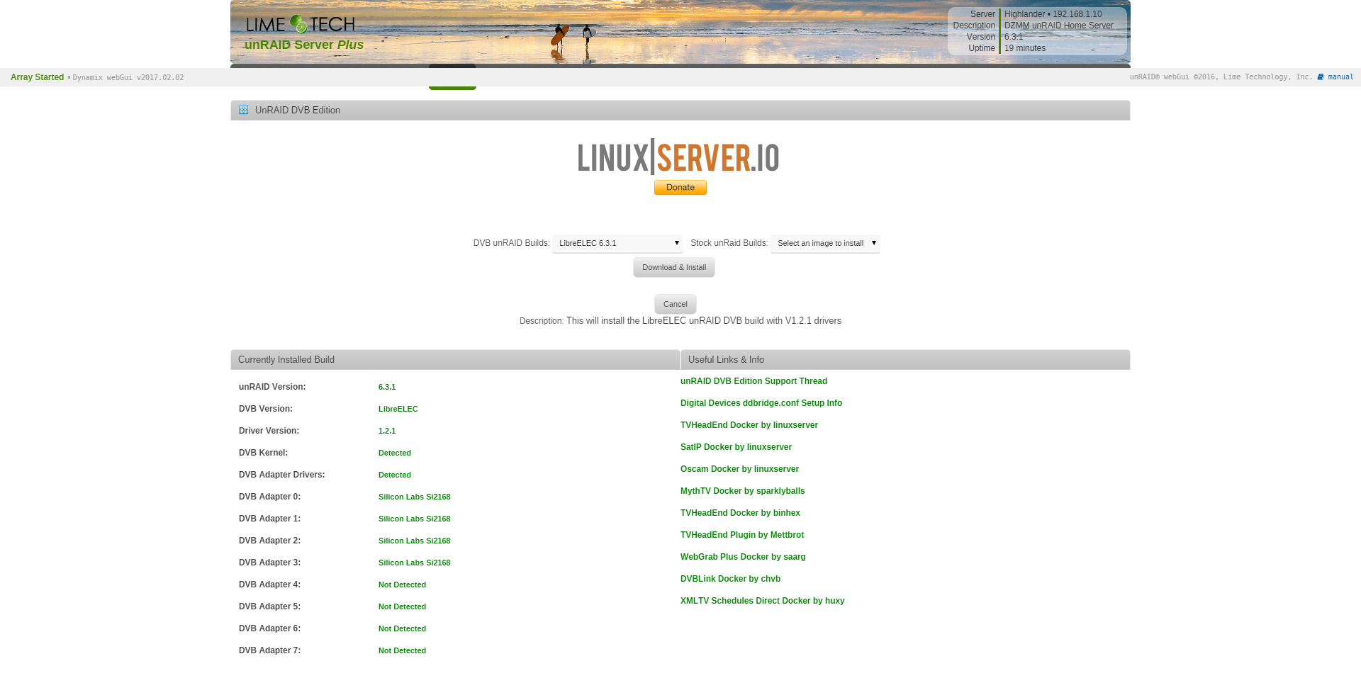

Thanks - sorted.  Tuners passed through - now having fun getting channels scanned.  Mini project for tonight to get Freeview working in TVheadend!
Pretty sure that firmware is included tbh.
It is.....
The firmware is present in the DVB build.  Can you post a screenshot of the Unraid DVB Plugin page please?  Like this....

ok, thing I'm getting somewhere.
https://linuxtv.org/wiki/index.php/Hauppauge_WinTV-quadHD_(DVB-T/T2/C)
Says I need firmware dvb-demod-si2168-b40-01.fw
[   28.368787] si2168 6-0064: Silicon Labs Si2168-B40 successfully identified
[   28.368938] si2168 6-0064: firmware version: B 4.0.2
[   28.370216] si2157 7-0060: Silicon Labs Si2147/2148/2157/2158 successfully attached
[   28.370392] DVB: registering new adapter (cx23885[1])
[   28.370566] cx23885 0000:0c:00.0: DVB: registering adapter 2 frontend 0 (Silicon Labs Si2168)...
[   28.371025] cx23885_dvb_register() allocating 1 frontend(s)
[   28.371190] cx23885[1]: cx23885 based dvb card
[   28.374962]  sdc: sdc1
[   28.375648] sd 2:0:0:0: [sdc] Attached SCSI disk
[   28.377177] i2c i2c-6: Added multiplexed i2c bus 10
[   28.377341] si2168 6-0066: Silicon Labs Si2168-B40 successfully identified
[   28.377502] si2168 6-0066: firmware version: B 4.0.2
[   28.378742] si2157 7-0062: Silicon Labs Si2147/2148/2157/2158 successfully attached
[   28.378900] DVB: registering new adapter (cx23885[1])
[   28.379049] cx23885 0000:0c:00.0: DVB: registering adapter 3 frontend 0 (Silicon Labs Si2168)...
Do I need to rollback somehow ?

Where do you see that you need firmware? I don't see anything wrong in the log.
the link breaks when I post https://linuxtv.org/wiki/index.php/Hauppauge_WinTV-quadHD_(DVB-T/T2/C)  - it loses the ')' after the 'C' at the end.
Link says firmware needed is:
dvb-demod-si2168-b40-01.fw , which is different to what I have via the plugin
The firmware isn't what's displayed in the above code.
If you look at the sample kernel output in this link you'll see your is indeed as it should be, no mention in the kernel output of which firmware is use.
The mention of the firmware version you keep referring to is below that and occurs at first tune, which isn't what you've posted above.
I've checked the LibreELEC file system and the firmware you refer to is definitely in the image.  You can check by running
[ -f /lib/firmware/dvb-demod-si2168-b40-01.fw ] && echo "Found" || echo "Not found"

I suggested earlier that you try the CrazyCat build, have you done so?
Checking the md5sum for CrazyCat firmware version and 4.0.25 it would appear it's the version you're looking for.
I hadn't seen this post and I'd logged on with the intention to feed back on how my CrazyCat 6.3.1. test went...
Brilliantly and the 4.0.25 firmware did the trick.  TVHeadend tuned all channels straightaway - I'd spent days trying before!  It was still a bit slow in Kodi for me, so I went back to dvblink in a docker as I'm more familiar with it and it's working well and finally passed WAF - getting the odd crash when changing channels and some initial buffering, but I think I can fix that in Kodi.
