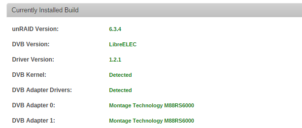

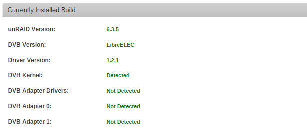

On 2016-9-6 at 2:10 PM, ProGEEK said:
Is there something wrong with RC5 ?
After updating to this build, my tuner card no longer works.
My card is a Hauppauge WinTV HVR400.
Shows up in lcpci as: Multimedia video controller: Conexant Systems, Inc. CX23887/8 PCIe Broadcast Audio and Video Decoder with 3D Comb (rev 04)
It usually uses the cx23885 driver, but trying to load this driver results in: modprobe: FATAL: Module cx23885 not found in directory /lib/modules/4.4.19-unRAID
Attached is what is seen from the admin panel both before and after update
lsmod from rc4

Hate to bring this up again, but seems support for the cx23885 is gone again in release 6.3.5 :(
Edited by ProGEEK
Something clearly got borked last time.  I did another build a couple of days ago that I never quite got around to uploading.  Can you all pull the v6.3.5 release again and test please?
Edited by CHBMB
Working for me thanks :)
yep, working again - thanks! :D
Same here, working again. Thanks
