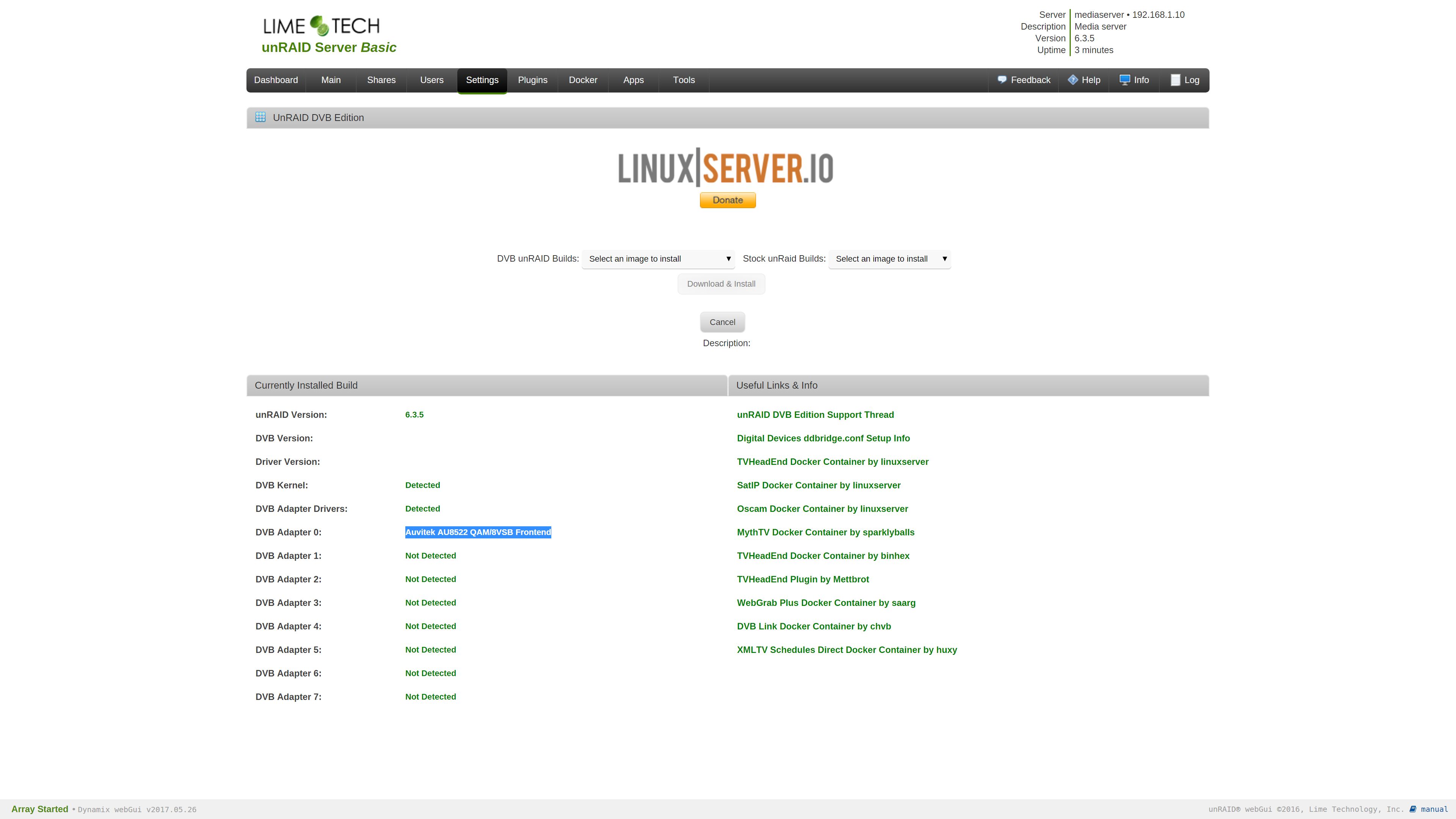

Just tried LE 6.4.0-rc6 with my HVR-950 and the adapter still isn't detected.
Can you post a screenshot of what the DVB plugin screen looks like on v6.3.5?
Just uploaded another rc6 build.  Just pull it from the DVB plugin again.  Definitely compiled all the modules needed for your card and firmware is in there too.  If this doesn't work, I'm going to be mighty confused!
Here's the screenshot of it working with 6.3.5.
Here's the output of lsusb for that device with 6.3.5:
Bus 003 Device 005: ID 2040:7200 Hauppauge

There's no LE 6.4.0-rc6 build available. I think you deleted the old version but didn't replace it with the new one.

@DMcK I should probably just give up!  Uploading them as we speak.  Give it a couple of minutes and should be good to go.
Still a no go. Maybe some change lime-technology made is impacting it.
I'm happy using my other tuner... the other 950 users might be out of luck though.

Just now, DMcK said:
Still a no go. Maybe some change lime-technologies made is impacting it.
Don't think you can blame LT for this one.  Far more likely to be a kernel change.  I activated absolutely everything in that last build and even checked the linuxtv wiki for what modules your card needs.....

Can you give me the output of
find /lib/modules/$(uname -r) -type f -name \*.ko
for both v6.3.5 and v6.4rc6?
Sure.
The output for 6.4rc6 is empty. I'll have to get you the output for 6.3.5 later tonight or tomorrow.
The output for 6.3.5 is empty too. Is that command correct?
I did notice the directories in that path appear to have a bunch of files in the format like dvbname.ko.gz. In 6.4rc6, I thought the filenames were like dvbname.ko.xz, but am not 100% sure. Does the compression type matter?
