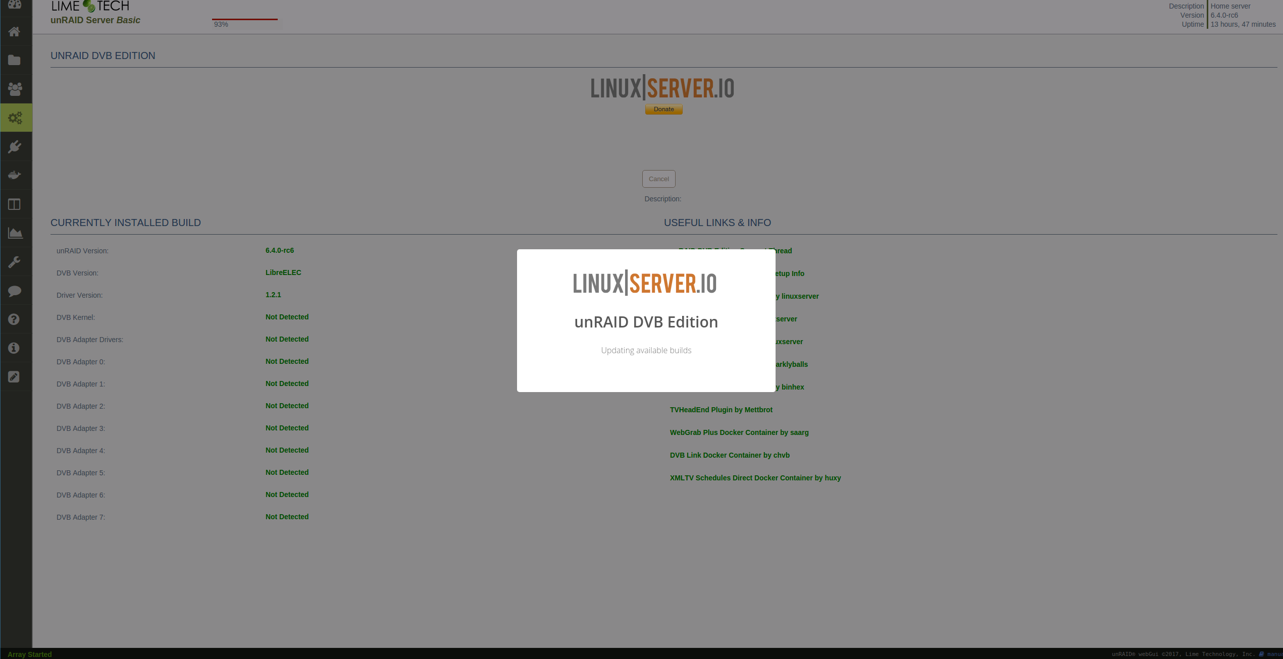

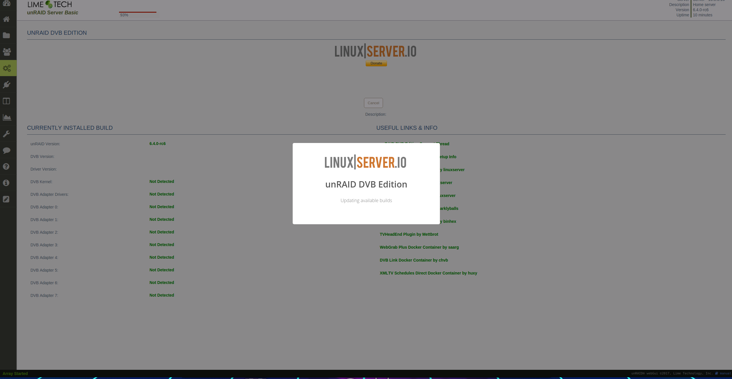

I upgraded to 6.4RC6 from 6.3.5 and tried to follow your instructions. The settings->unRAIDDVB page keeps fetching images however and never stops loading.
Then I copied all the non-checksum files from http://files.linuxserver.io/unraid-dvb/6-4-0-rc6/libreelec/ to my flash drive, and now I can see (while the page is still loading) that the currently installed build is LibreElec version 1.2.1, but there's no DVB Kernel detected. (So also no devices, and therefore nothing showing up in my TVHeadend container (with device passed through).)
I've tried to trace back why the page doesn't finish loading, but all I can see are (nginx) timeouts of exec.php in the plugin directory...
Can't explain why the DVB kernel isn't showing up, examined LibreElec thoroughly yesterday and was using it on my test system.

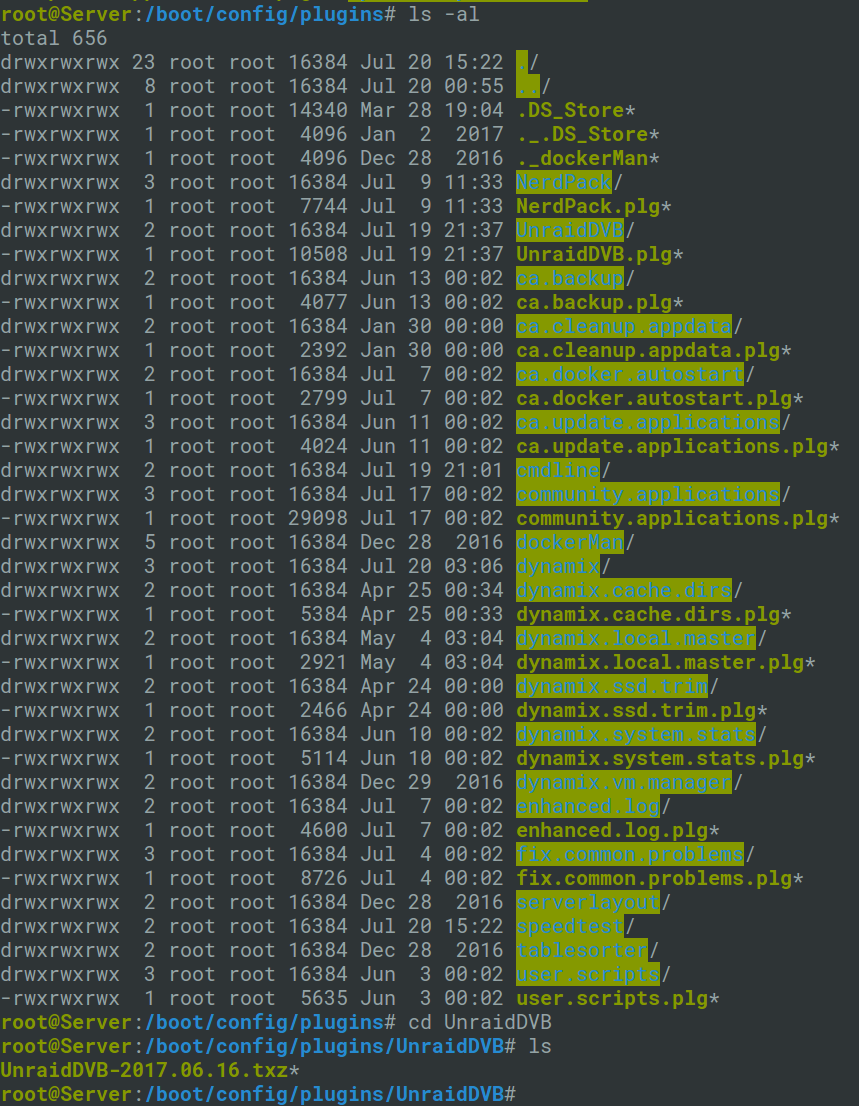

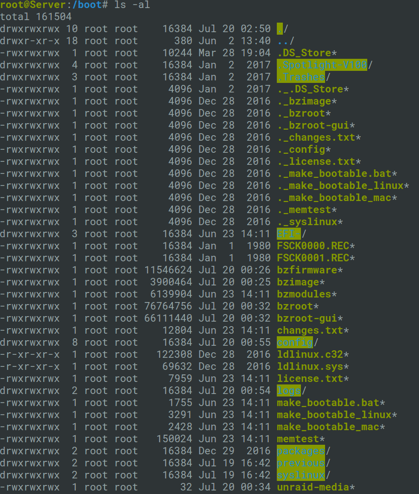

Here are the contents of my /boot (and /boot/config/plugins) folders, maybe it shows something wrong:

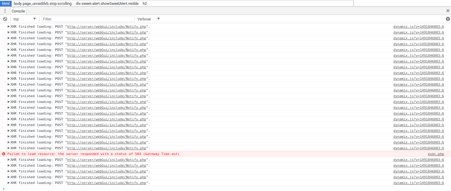

Only other possibility is a javascript error.  Can go back to the settings, load unRaid DVB, wait a couple of minutes, then:
(I'm assuming you're using Chrome)
Right click anywhere within the window and say inspect.  Within the new window, click on "console" and then post whatever errors appear.
Unfortunately I get the same behaviour as before I went through unRAID versions (see screenshot on the previous page):
Edit: Occasionally I seem to be able to also produce the following warning, not sure whether it's related:
[Violation] Added non-passive event listener to a scroll-blocking 'mousewheel' event. Consider marking event handler as 'passive' to make the page more responsive. jquery-2.1.1.min.js:3
Edited by tbrasser
added occasionaly appearing warning
The browser is timing out on the response from the code.  And since there's no response the popup won't close.  Not sure why as I've ran that popup waiting for a response for over a half hour at a time.
