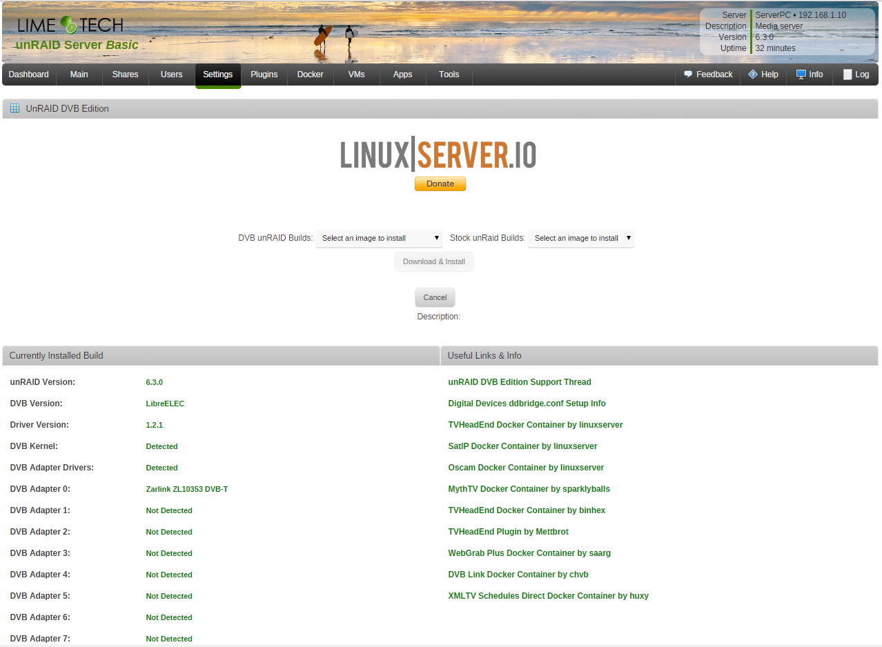

Ahh, I didn't know i can click the icon for the settings! Thank you.

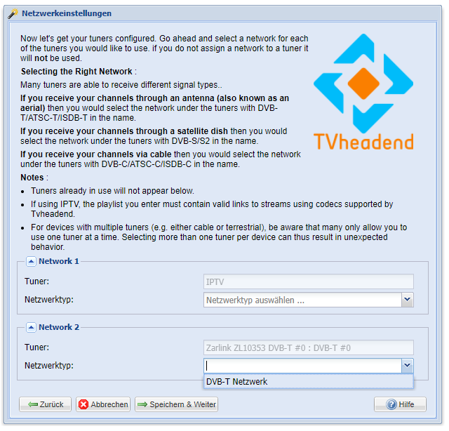

But I have another problem now: my triple tv stick gets recognized for DVB-T, but I want to use DVB-C.. Can I change this?

Not entirely sure exactly what stick you have but here's some info, can't see any of those that support dvb-c
https://www.linuxtv.org/wiki/index.php/TerraTec
Damn, you're right.. That's the problem.. Thanks tho 9_9

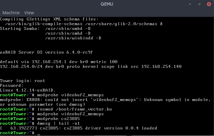

The problem doesnt lie with the cx23885 module, but actually videobuf2.
Try loading the videobuf2_memops module, and thats what gives you the error. There are symbols missing from the kernel, and as far as I can tell, all the builds you have on the server all have an identical bzimage file

As far as I can tell, all the bzimage files generated by all the builds are identical (Size wise anyway) and none of them seem to include FRAME_VECTOR support, which is what videobuf2_memops requires to load. So im trying various ways of building the kernel to get these static functions compiled in (Cause they're configured to be compiled, but being seem to be getting ignored)

They're part of the symbol map, but not in the kernel itself which is weird. Im trying to compile as a standalone module, see what milage that produces
@CHBMB @Zan Its exactly as I suspected. Have confirmed frame_vector is not part of the kernel.
I compiled frame_vector as a kernel module, loaded it manually and now i have videobuf2_memops and cx23885 loading correctly.
So next step is, figure out why the he-double-hockysticks frame_vector isnt being compiled into the module statically as its supposed to be
