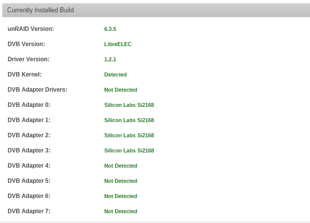

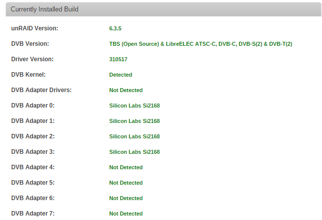

I am stuck with a bit of a problem, not sure if it's my stupidity or a genuine issue. I have a HAUPPAUGE WinTV-quadHD tuner and I have installed the TBS Open Source 6.3.5 Build. When I first turn on the server and go to the DVB page the 'DVB Adapter Drivers' column shows as 'Detected'. Then when I open Plex server the tuner shows up for about 30 seconds and then disappears. When I go back to the DVB page the 'DVB Adapter Drivers' column now shows as 'Not Detected'?

Nope i'm still having the same issue where it detects at first then changes to not detected.
I suspect this is Plex doing something, can you try restarting the system and not starting Plex and see what happens, instead try installing TVH to troubleshoot.
The parameter that "disappears" actually checks for the existence of a folder called /dev/dvb/adapter0/frontend0

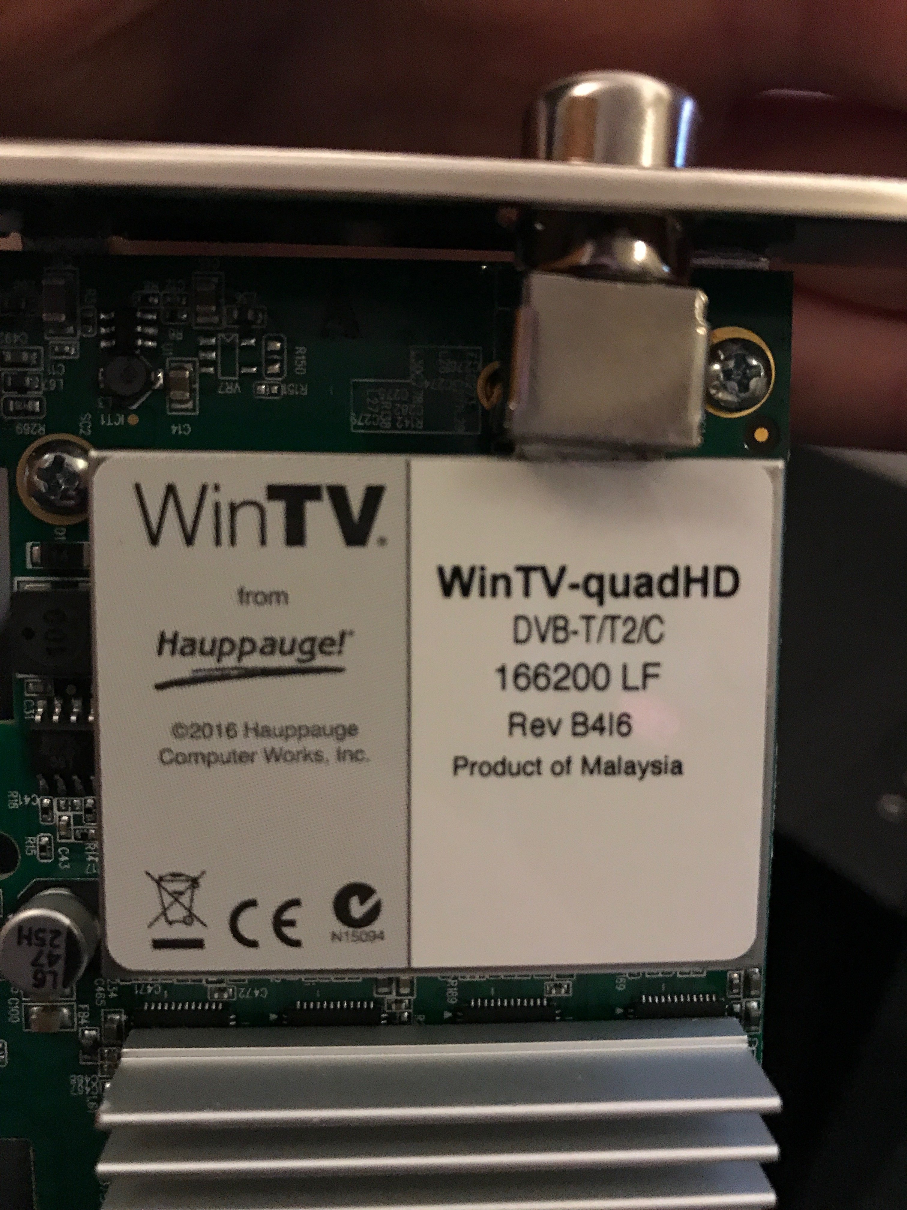

The UK/Europe version. There are a couple versions using a different chip, I have attached a photo of my exact card:
And can I confirm you've had the card working in a VM or another system?
After that error in TVH was the DVB adapter drivers still showing if you refreshed the DVB plugin page?
Something very unusual going on with this card that I don't understand.  It SHOULD just work as the DVB drivers and firmware are all present.  But it appears to disappear, not still passing it through to a VM are you?  That would snatch it out the host system I guess.
