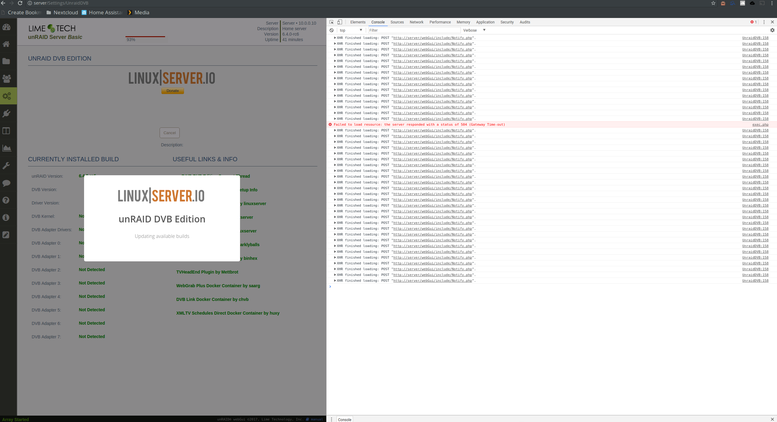

I tried firefox on the IP, but again, same thing.
The last resort is to download the file attached to the flash drive
You mean the UnraidDVB-2017.06.16.txz file to where?
  • Replies 1.7k
  • Views 346.6k
The file attached to the post.  Save it on the flash drive, then enter in that command.  I got rid of the popup in the hopes that something might appear.  It's a hail-mary.
I tried that now. Also directly on the server (booted in gui mode). Still no luck. Im giving up for today. I'll post back here when I have found out more.
EDIT: I once again copied all the images to /boot manually and everything works! (well except for the DVB plugin, but the manual update worked, I can use my tuners now!)
Thanks for both of your time!
