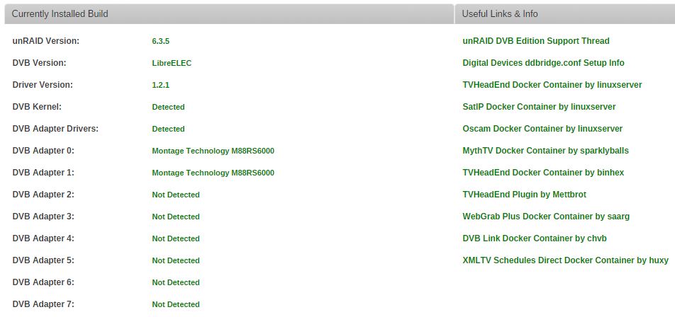

I am new to this DVB version and have tried using LIBRELEC 6.3.5 to use my DVBSky V 3.0 S952 (Dual Tuner)
As you can see they are both detected but only Tuner 0 works as there is no signal detected on Tuner 1? I have swapped the coax cables over and still only Tuner 0 works.  I can confirm that both tuners work in my other system.  Any ideas?
You could try the CrazyCat build or one of the newer release candidates.
