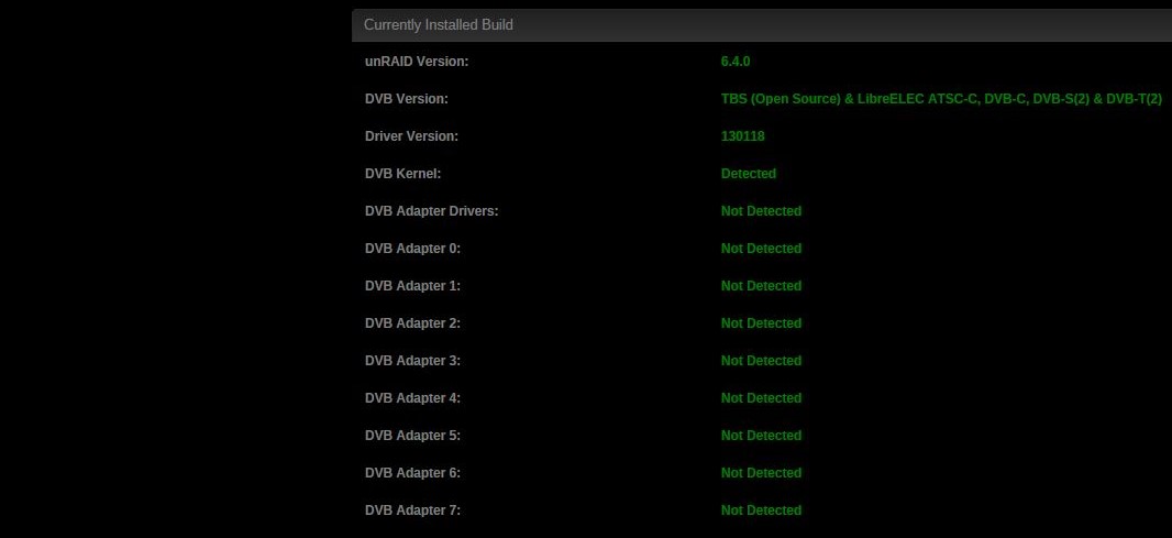

On 14.01.2018 at 1:07 PM, CHBMB said:
@w^w @Cessquill
The v6.4.0 release has some changes regarding your cards, be grateful if either of you tested the TBS Opensource release please.....
Already tested but without any luck. See screen:
OK, had another look at this, turns out the fix I implemented didn't work as the instructions aren't quite right on the TBS site.  I've filed an issue with them and implemented a different way of achieving the same goal.
Once that's finished compiling, I'll upload a new TBS build and post back here.
Downloaded from DVB plugin and tested. Unfortunatelly, problem still exist - this happened on my new unRAID build.
BUT
I tested it on my an old unRAID build and everything is OK. All 4 DVB adapters are listed on DVB plugin with 6.4.0 unRAID DVB version.
Edited by w^w
update
BUT
Oh, wasn't expecting that.....
Now I'm really confused. Got one idea, lemme chat to a mate I know about it and get back to you.
@w^w Can you post your hardware specs please (mobo) of old and new server.
Also, might be worth a look here.
CHBMB thanks. Everything is clear now. In my new unRAID build I have ASUS P10S-M WS mobo which have PCI-E Gen3 and doesn't have Gen1 support so there is no way to detect my old TBS6984 PCI-E Gen1 card :(
Are you sure? There should be a setting to force it to older gen.
It is. There is something like "asus dmi max link speed" which have default value setted to AUTO. But when I change it to Gen1 my card is still not detected.
Have you tried to force the L0's to what i specified in the post @CHBMB linked? If you have that option that is.
There is no such option in my BIOS.
It's the ASPM option. It looks like it's in PEG port configuration and also one called DMI Link ASPM control in DMI/OPI configuration
Ooo. Need to investigate it when I back to home. Thanks!
No problemo. I hope it fixes the issue.
Tested almost everything but still without any luck :(
