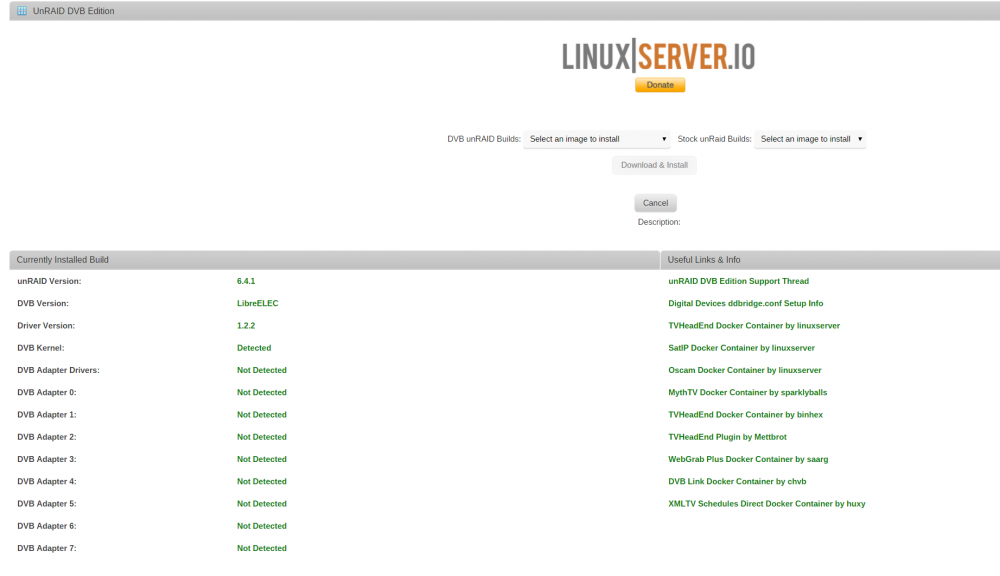

8 hours ago, hackztor said:
6.4.1 RC1 works, RC2 does not.
Below is what it looks like in rc2 and final.
OK, I've rebuilt the files, just uploading, try v6.4.1 again please.  Definitely included the right module...
Edited by CHBMB
  • Replies 1.7k
  • Views 341.5k

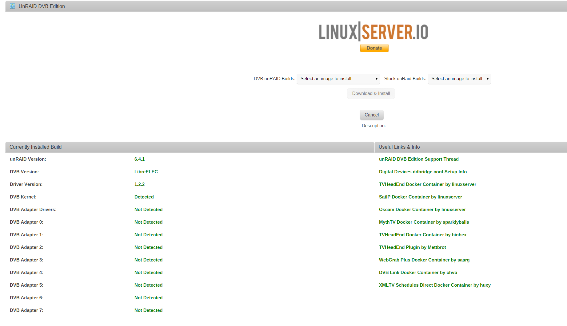

7 hours ago, Akrodha said:
I cannot get anything but this screen after installing. It has been sitting like that for over two hours...
Any suggestions? I have removed and reinstalled twice for the same result.
edit: Running 6.4.1
That means you can't hit our server for some reason.
SSH to your server or use the new terminal feature in v6.4.1 and run
ping -c5 mirror.linuxserver.io
And post the results.
Doesn't seem to be a problem hitting the server.
Adding to hosts has fixed it though,   thanks.
