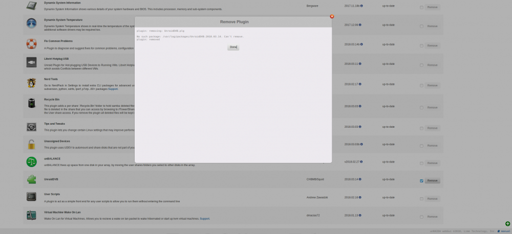

I was on 6.5.0-rc6 and when I wanted to upgrade to 6.5.0 weird things started happening.
Initially I got an error on the DVB plugin page. So I tried to uninstall the plugin which said it wasn't installed in the first place.
Then I tried installing it (again), but I got errors when it tried to extract the tar file (errorcode 2).
What I did is upgrade to 6.5.0 stock using the normal upgrade path. And after that I tried installing the plugin again.
Same error:
plugin: installing: https://raw.githubusercontent.com/linuxserver/Unraid-DVB-Plugin/master/plugins/UnraidDVB.plg
plugin: downloading https://raw.githubusercontent.com/linuxserver/Unraid-DVB-Plugin/master/plugins/UnraidDVB.plg
plugin: downloading: https://raw.githubusercontent.com/linuxserver/Unraid-DVB-Plugin/master/plugins/UnraidDVB.plg ... done
plugin: downloading: https://raw.github.com/linuxserver/Unraid-DVB-Plugin/master/archive/UnraidDVB-2018.03.14.txz ... done
| Installing new package /boot/config/plugins/UnraidDVB/UnraidDVB-2018.03.14.txz
Verifying package UnraidDVB-2018.03.14.txz.
Unable to install /boot/config/plugins/UnraidDVB/UnraidDVB-2018.03.14.txz: tar archive is corrupt (tar returned error code 2)
UnraidDVB has been installed.
CHBMB/Squid
Version: 2018.03.14
plugin: installed
Is there anything I can do to fix this.
Before the upgrade I had the same issues with CA, the apps tab was not showing anymore  (6.5.0-rc6) but it now is back on 6.5.0..
Here's a screenshot of me uninstalling the plugin after it failed to correctly install:
Edited by tbrasser
Added screenshot of removal of not installed plugin.

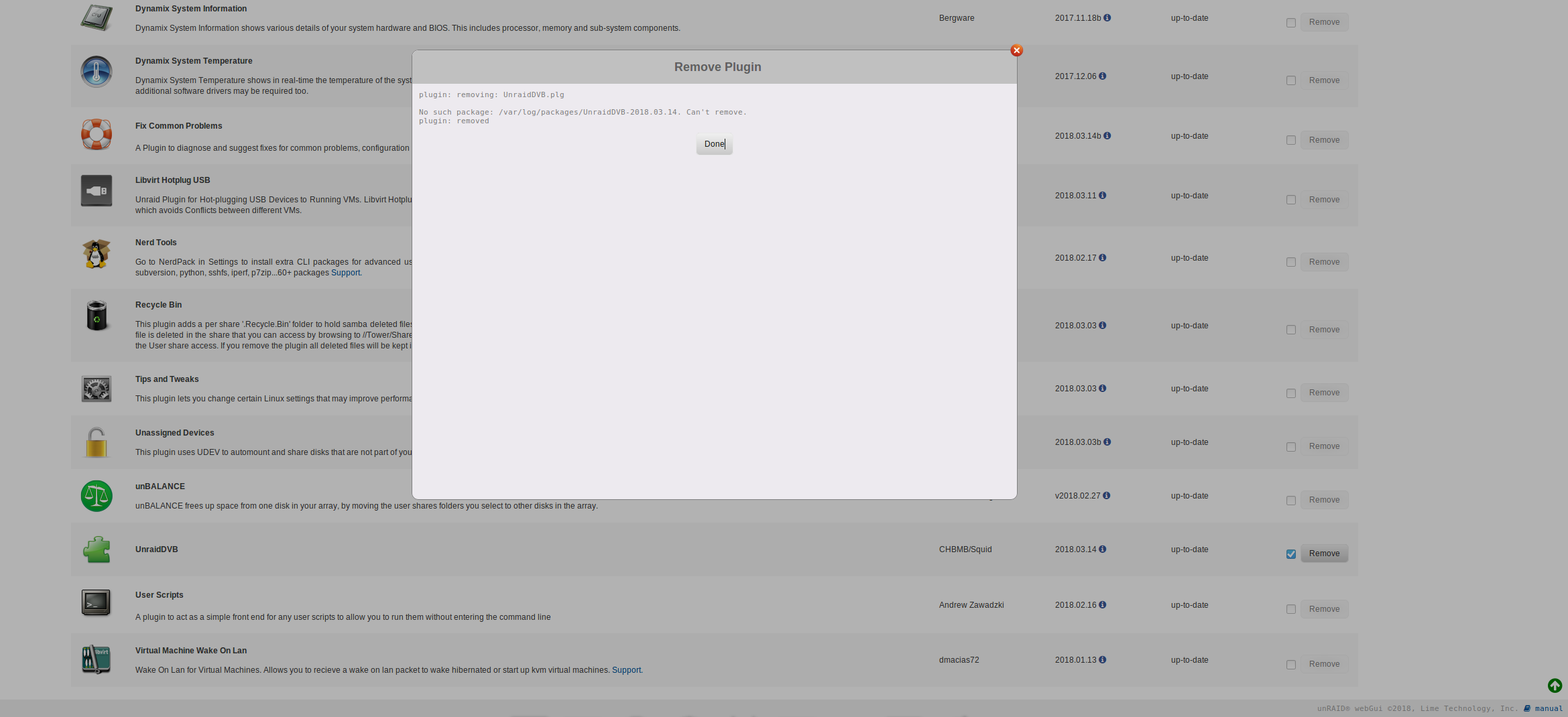

Same error:
CHBMB/Squid
Version: 2018.03.14
plugin: installed
No idea, have check the plugin at my end and it's working fine.  Maybe @Squid might have an idea, as it looks more of a general problem that just with this plugin.
Do you have the MD5 entry on the <File> for the txz.  sorry at work.    I'm assuming that a fresh install works for @CHBMB
I narrowed it down to my /var filling up with syslogs. Turned out my VM setup with primary nvidia passtrhough is giving me BARs warnings continuesly. Not starting any VM's on boot made everything work again.
So it didn't have anything to do with this plugin in the end, got LibreElec 6.5.0 running now!
Thanks for the help anyway, and if someone knows how to stop uninteresting log entries from filling up the partition (or is familiar with the type of error I got, posted in the 6.5.0 release thread) feel free to post it (A)

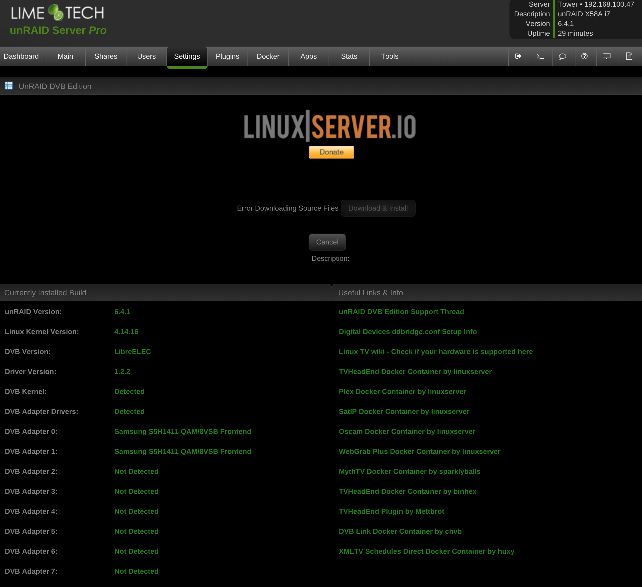

Hi there, I'm having the same problem here, the unRAIDDVB plugin times out looking for the server, "Error downloading source files". Here is my ping result:
Linux 4.14.16-unRAID.
root@Tower:~# ping -c5 mirror.linuxserver.io
PING mirror.linuxserver.io (46.101.228.190) 56(84) bytes of data.
64 bytes from 46.101.228.190: icmp_seq=1 ttl=53 time=128 ms
64 bytes from 46.101.228.190: icmp_seq=2 ttl=53 time=129 ms
64 bytes from 46.101.228.190: icmp_seq=3 ttl=53 time=127 ms
64 bytes from 46.101.228.190: icmp_seq=4 ttl=53 time=127 ms
64 bytes from 46.101.228.190: icmp_seq=5 ttl=53 time=127 ms
--- mirror.linuxserver.io ping statistics ---
5 packets transmitted, 5 received, 0% packet loss, time 4006ms
rtt min/avg/max/mdev = 127.704/128.259/129.367/0.668 ms
I'm on unRAID 6.4.1, trying to upgrade to 6.5.0. I'm using a Hauppauge WinTV HVR-2250.
Thanks for the help, logs and screenshot attached.
tower-diagnostics-20180401-0638.zip
Digital Ocean which hosts our files has an issue at the moment....
Sent from my Mi A1 using Tapatalk
Welcome to the club  :D
Looks like they fixed it and things are working again.
Confirmed, they're back up now, I'm upgraded to LibreElec 6.50 version unRAID.  Cheers!

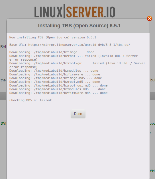

I'm getting errors trying to download TBS open source:
5adefd9be1d97_FireShotCapture91-Highlander_UnraidDVB_-https___1d087a25aac48109ee9a15217a.png.71d4db76574d0520156bdde814eaafdb.png
Just spent 10mins using VPN and SSH figured out the issue, removed the non-working builds and will run another build. Give it an hour or so.
Thanks worked
