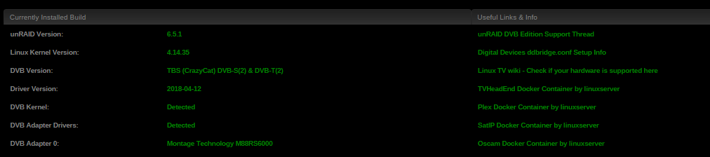

Hello All,
I'm really hoping someone might be able to assist with regards to the Hauppage WinTV-Starburst 2 (PCIe, DVB-S / S2) Model 150300 (or 150310), that I purchased recently.  After reading that this card was supported in Linux, I didn't think it would be too hard to get it up and running in unRAID, but unfortunately I didn't appreciate what a minefield DVB cards could be.
Although the card is detected as a Montage Technology M88RS6000, I cannot find any channels in the TVHeadend docker (although the card works perfectly in a Windows VM).  As such, I wondered if someone might have had success with this card before and could point me in the direction of a solution?  Unfortunately judging from the forum posts I've read, I fear that is unlikely so failing that, could someone point me in the direction of cheap DVB-S/S2 card (ideally with 2 inputs if possible) that is know to work with unRIAD and TVHeadend please?
Many thanks in advance and a big thank you to everyone who puts their time and effort into unRAID DVB.

6 minutes ago, Pendy said:
Hello All,
Although the card is detected as a Montage Technology M88RS6000, I cannot find any channels in the TVHeadend docker (although the card works perfectly in a Windows VM).  As such, I wondered if someone might have had success with this card before?  Unfortunately judging from the forum posts I've read, I fear that is unlikely so failing that, could someone point me in the direction of cheap DVB-S/S2 card (ideally with 2 inputs if possible) that is know to work with unRIAD and TVHeadend please?
All the best
Post your docker run command for TVHeadend,  Link on how to do so is in my signature.
Also you haven't said which DVB build you're using.  A screenshot of the DVB settings page might be useful too.

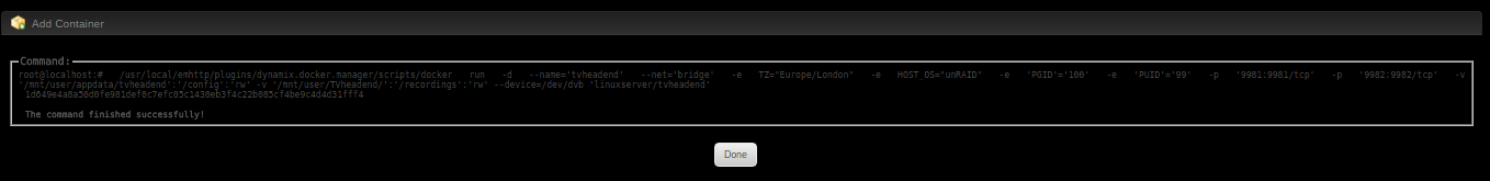

Good Evening CHBMB,
Thank you for your fast message and apologies for my delayed response.
I've tried all of the different DVB builds with the both the TBS CrazyCat and TBS Opensource builds finding the card as noted above.
With the TBS CrazyCat 6.5.1 build, the system suffers instability, freezing/locking when searching for Channels in TVHeadend after first install (although it does register a SNR and Signal Strength reading), as well as other docker contains and unRAID having issues and ultimately leaving no other recourse than forcing an unexpected reboot.   The TVHeadend docker then doesn't show in the GUI, or Terminal.  Reinstalling (albeit probably making the situation worse) yields the docker run command illustrated below and populates TVHeadend back into the GUI.
With the TBS Opensource build, the TVHeadend scan completes to 100% in a fraction of a second (with no SNR or Signal Strength), leading me to believe that the card is not really being connected with.
Docker Run Command:
DVB Settings Page:
Hopefully I've missed something obvious and it's an easy fix, but it's not a happy chappy at the minute unfortunately.

On 5/10/2018 at 10:28 PM, Pendy said:
Good Evening CHBMB,
Docker Run Command:
DVB Settings Page:
Thanks again for your time,
Have you tried the LibreELEC build?  That one would seem to me to be the most suitable one to be honest.
