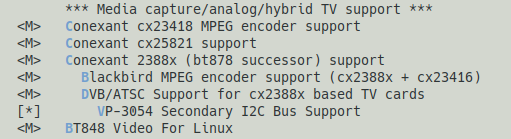

@du.perin it looks like cx23885 is missing when the kernel compiles despite being selected as a module.  Tried three times now to ensure it's not a PEBKAC error, log doesn't show any attempt at building it and /lib/modules/4.18.8-unRAID/kernel/drivers/media/pci/cx23885/ doesn't exist.
Scouring the log of the compilation doesn't seem to show any mention of it that I can see.  You can take a look here.
Looking at the kernel bug list, the only one I can find that may be relevant is this one, but I'm unconvinced that's the issue as it's a crash on unloading and it's a bit tricky to unload something that isn't present.....
Long and the short of it, I haven't got a clue what the issue is and have asked one of the LibreELEC experts for his opinion (Always my go-to guy for this sort of thing)
In the meantime I don't think there's much else I can suggest, the only thing I wondered is if it might be an idea to try the CrazyCat build as it's from a different tree, and there's an outside chance it might work.
EDIT: Had a look, it's not in that build either.
If anyone else has any ideas I'm all ears.

Turns out cx2388x isn't the correct module at all, it's a completely different module to cx23885.  I hadn't activated a prerequisite for cx23885 to appear.  My bad, got some help from LibreELEC and got to say, don't think I would have spotted it without a second pair of eye.  v6.6.0 builds all updated now.
CrazyCat has removed his linux_media repo again, so I've done his build against the vanilla TBS linux_media.  Should work ok.
