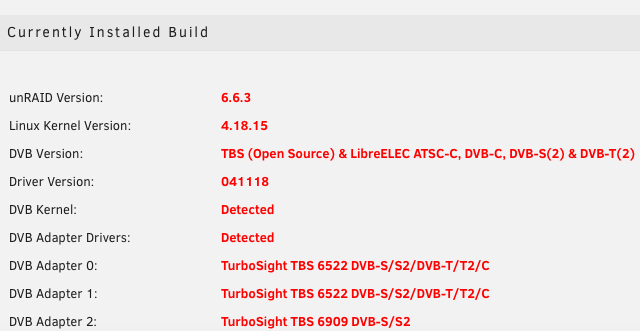

Hopefully someone could enlighten me - i have been trying to use this plugin and i have tried all version of libreelec that is available and I keep getting Checking MD5's: failed!
I am running Unraid 6.6.1 and I have been crawling through this thread, the forum and google in general and cannot find any information as to why this is the case.
**update** fixed it by looking at install.php and finding out what to download and where to copy the downloaded file. No idea why the install script fail at the md5 check...
**update #2** looks like I can't seem to get the adapter driver to detect, currently using Sony PlayTV as my tuner and as per the earlier post it seems that 6.5.3 is the version that works but I am getting the following. Any suggestion?
**update #3** After spending the last day trying to figure this out - finally found an obscure post with regards to the Sony PlayTV not working correctly when using USB 3.0 ports - plugged it into my USB 2.0 port and it shows that is detected!
Edited by RaihaX

bzroot and bzroot-gui files are missing in your tbs-os package. There are md5 files for them but without bzroot and bzroot-gui files.
yes in all packages ;) because are same like in original one ;) so first update to original 6.6.3 then just replace files from my packages in /boot or /flash and reboot
tested and working ;)
Edited by piotrasd
I confirm. It works. Dzięki :)
