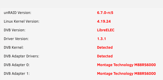

Can you screenshot the DVB plugin page for me please?  And try and tell me what steps you've taken so far that has shown it's not working.

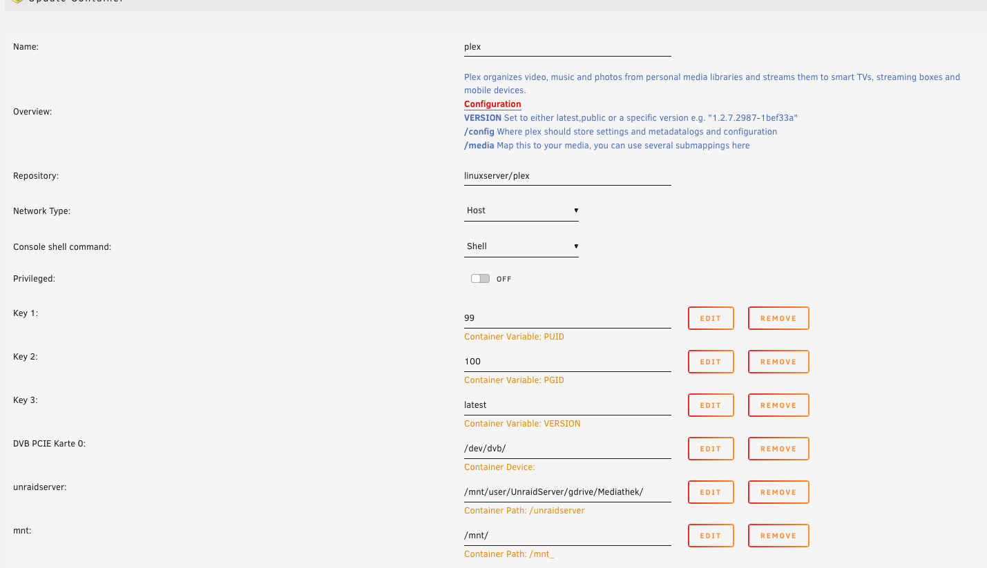

Hello and thanks for the reply.
Pic of the Pluginpage attached.
1978014270_Bildschirmfoto2019-03-27um21_56_18.png.0f1197928745fd39c6f335a3e1659b74.png
And what iv'e done:
  • Install the Plugin
  • switched to DVB-Unraid

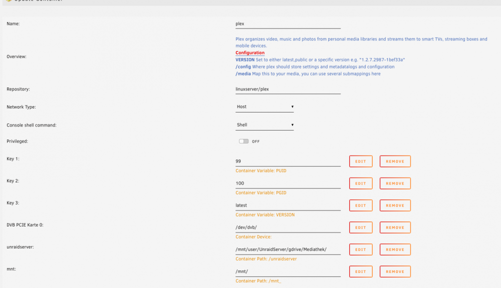

  • give the container access to the device (also attached)
  • 1433368905_Bildschirmfoto2019-03-27um21_59_36.thumb.png.cac124c8cedc7a8a12415ddec1b63376.png

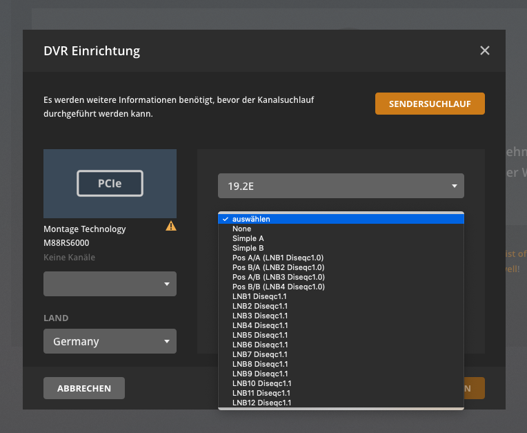

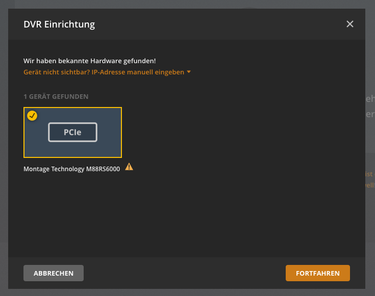

  • then went into Plex and stated to configure
  • 183857497_Bildschirmfoto2019-03-27um22_00_59.png.a8e99dea689a18b8961a650c14401fd4.png
  • i have to say i'm not sure what i have to configure here

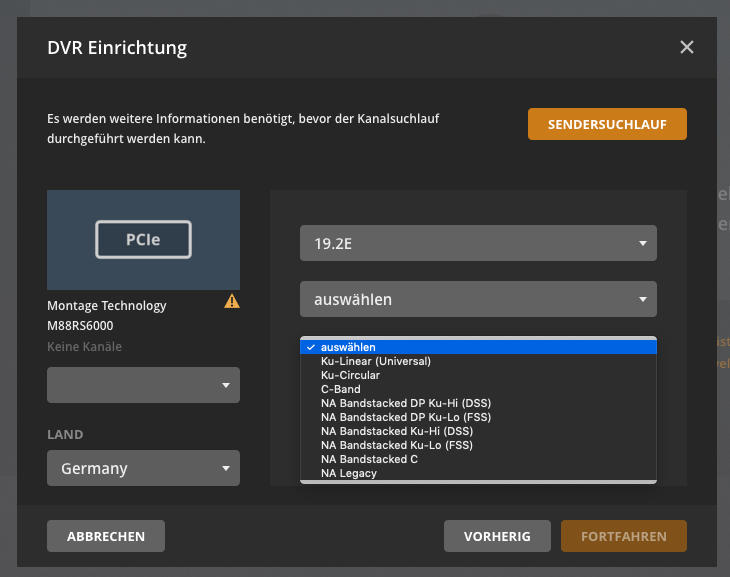

  • the first is my region especially the direction of my Satellite bowl
  • but the other two i don't know
  • 1129452980_Bildschirmfoto2019-03-27um22_02_42.png.6b6d19f761b42017851f2f4348b8713f.png
  • 1996096810_Bildschirmfoto2019-03-27um22_02_52.png.74245cb598cbce599d9d73423fbf5b7c.png
  • i tried a lot of constellations but no one worked...
  • so i thought it was a software problem...
    but may someone could point me in the right direction...

The plugin is working as it should.
If you connect directly to the LNB, choose none in the first part and ku-linear universal in the second.
2 minutes ago, cmeyer86 said:
As @saarg says the plugin is working as intended, configuring Plex is beyond the scope of this plugin.  Would have been helpful if you'd stated that the card was detected in your initial post as I've been holding up v6.7.0rc6 waiting to see if I needed to change something to get your card working.... 🤨
Ok, I'm sorry
because the font of the page is red, and not green as in the other pictures, I thought there are problems here as well.
58 minutes ago, cmeyer86 said:
Ok, I'm sorry
No worries, I changed the colour scheme with the new revamp of the Unraid webui.  Never mind!

Because thus Card was already running in Ubuntu and also under Win Server 2016.
if this was working inside plex on ubuntu or winserver, wich settings for your card did you use there ?
