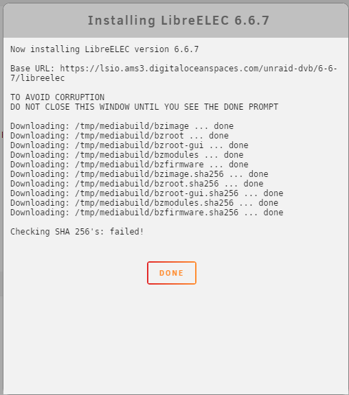

I am running into the following issue when trying to install LibreELEC v6.6.7 -
Now installing LibreELEC version 6.6.7
Base URL: https://lsio.ams3.digitaloceanspaces.com/unraid-dvb/6-6-7/libreelec
TO AVOID CORRUPTION
DO NOT CLOSE THIS WINDOW UNTIL YOU SEE THE DONE PROMPT
Downloading: /tmp/mediabuild/bzimage ... done
Downloading: /tmp/mediabuild/bzroot ... failed (Invalid URL / Server error response)
Downloading: /tmp/mediabuild/bzroot-gui ... done
Downloading: /tmp/mediabuild/bzmodules ... failed (Invalid URL / Server error response)
Downloading: /tmp/mediabuild/bzfirmware ... done
Downloading: /tmp/mediabuild/bzimage.sha256 ... failed (Invalid URL / Server error response)
Downloading: /tmp/mediabuild/bzroot.sha256 ... done
Downloading: /tmp/mediabuild/bzroot-gui.sha256 ... done
Downloading: /tmp/mediabuild/bzmodules.sha256 ... done
Downloading: /tmp/mediabuild/bzfirmware.sha256 ... done
Checking SHA 256's: failed!
Thanks!

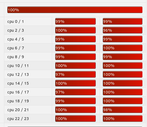

Incidentally for anyone that's interested, here's what my CPUs on my VM look like when compiling these.....

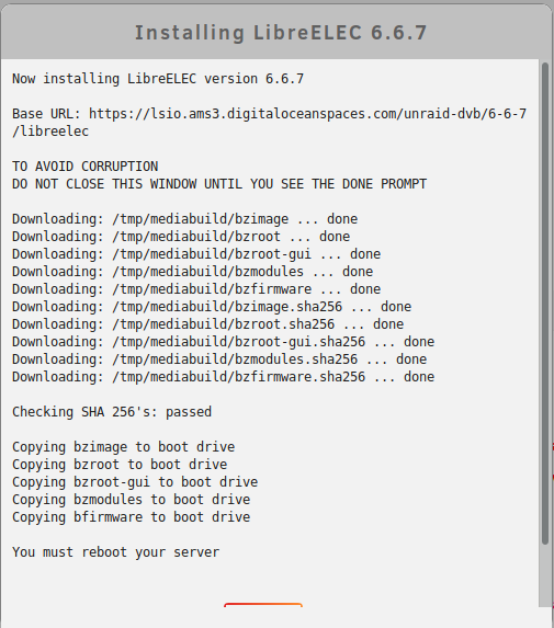

Thank you very much CHBMB.  I was running into this problem a week ago, tried it again last night and ran into the same failed checksum.  Hadn't had a chance to troubleshoot yet, my internet is so bad it takes about an hour to get everything.
Will try again tonight and report back.
I've checked all the 6.6.7 builds and can confirm they're all good server side.  Haven't checked all the other builds, but have done random checks on some builds so if you get an error let me know and I'll check it out.
EDIT: Sure enough, it was my abysmal internet.  With faster speed everything downloaded and checked out correctly, and I now have a working TV tuner! Thanks again.
Must be something on my side then.  Though it says 'done' in the status, I wonder if my poor internet is causing the download to time out or something like that.  I'll see if I can rig up a phone tether or maybe take the whole thing into work and try again.
