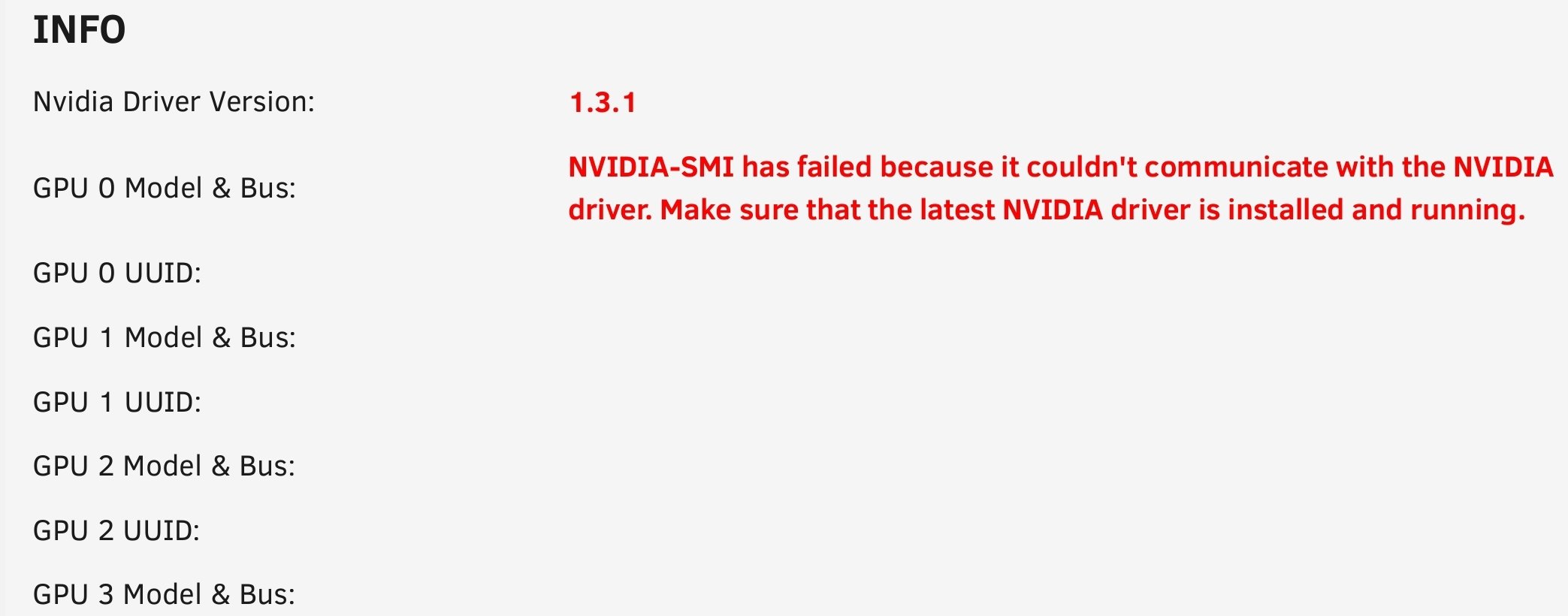

@CHBMB
Thanks for keeping with this (do you have a Patron we can throw support your way?)
I followed your instructions above.
DVB shows in Unraid ✓
Tuners work in Plex ✓
Nvidia GTX 1070 shows in Unraid ✗
https://imgur.com/a/JB7NdTv
The Nvidia Unraid plugin still reports the following error
NVIDIA-SMI has failed because it couldn't communicate with the NVIDIA driver. Make sure that the latest NVIDIA driver is installed and running.
And no cards show up. I don't know of any other way to get the UUID for the card other than to go to the plugin so I can't brute force test it with the docker. And I've verified that the GTX 1070 shows up in the "Tools > System Devices" page.
Let me know what else I can check or test for you. (I'm a application software engineer but not a lot of experience in system software development but I'm comfortable in a terminal so i don't mind digging)

Thanks for that. I'll have a think about whay to do next.....
