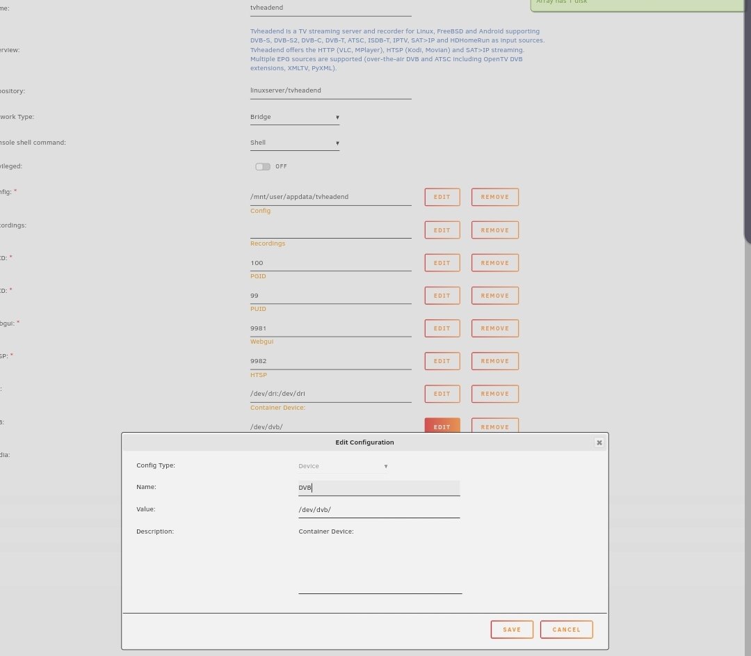

I have a DVBSky s960 S2 tuner, how would I go on adding this to TVheadend?
I've added the extra parameter "--device=/dev/dvb" Without any success.
It's like I'm not able to see the device in TVHeadend?

I have the same device and it are working good.

OH nice thanks! Will try out the LibraELEC drivers!

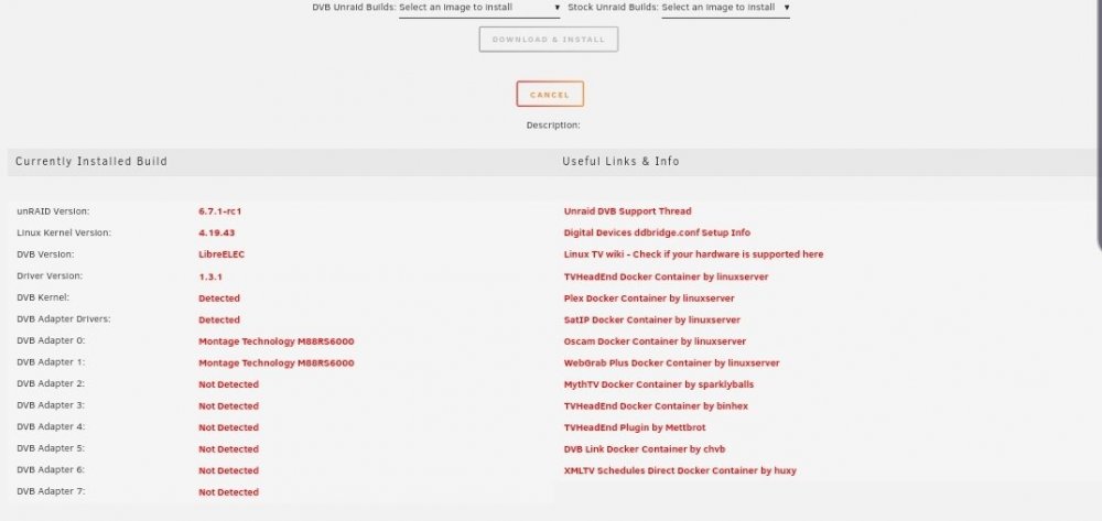

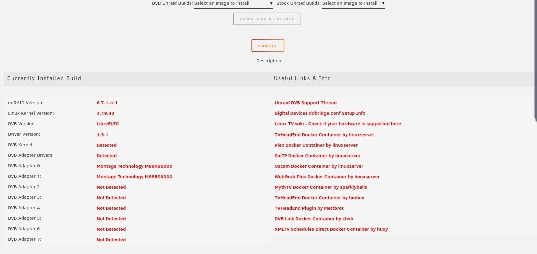

@Jimmy Nowhere near enough info for me to go on.  Are we talking about generic DVB build here or the Nvidia/DVB build above?
Post a screenshot of your working install.  /dev/dvb/ is just your DVB card, same for everyone, but without knowing what your card is, I'm in the dark.
It's the Generic build for LIbreElec6.7.1rc2
1) LibreElec6.71rc1 is working fine per first screenshot
2) Installing rc2 per second screenshot
3) Docker failing per third-fourth screenshot

As an explanation, The last two screenshots aren't useful.  The second shows it downloaded fine, which isn't the issue, and Plex logs offer nothing as if there's a problem with the DVB drivers, I wouldn't expect Plex LiveTV to work.  The pertinent information is all on the DVB plugin screen.  So just to confirm, can you post a screenshot of rc2.  Also, again, what is your DVB card?
DVB is Hauppauge-955Q (USB).
Here's the DVB plugin screen for rc2 :
