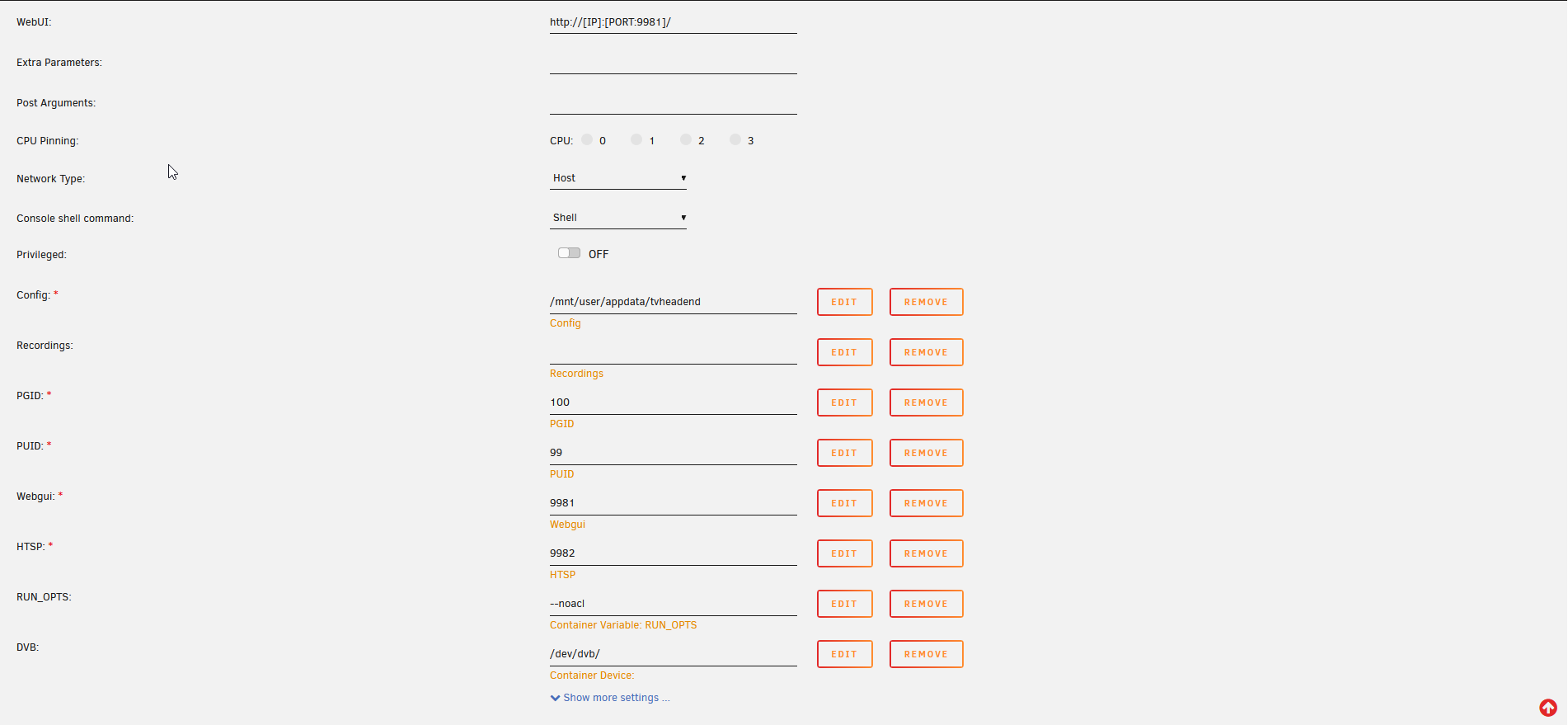

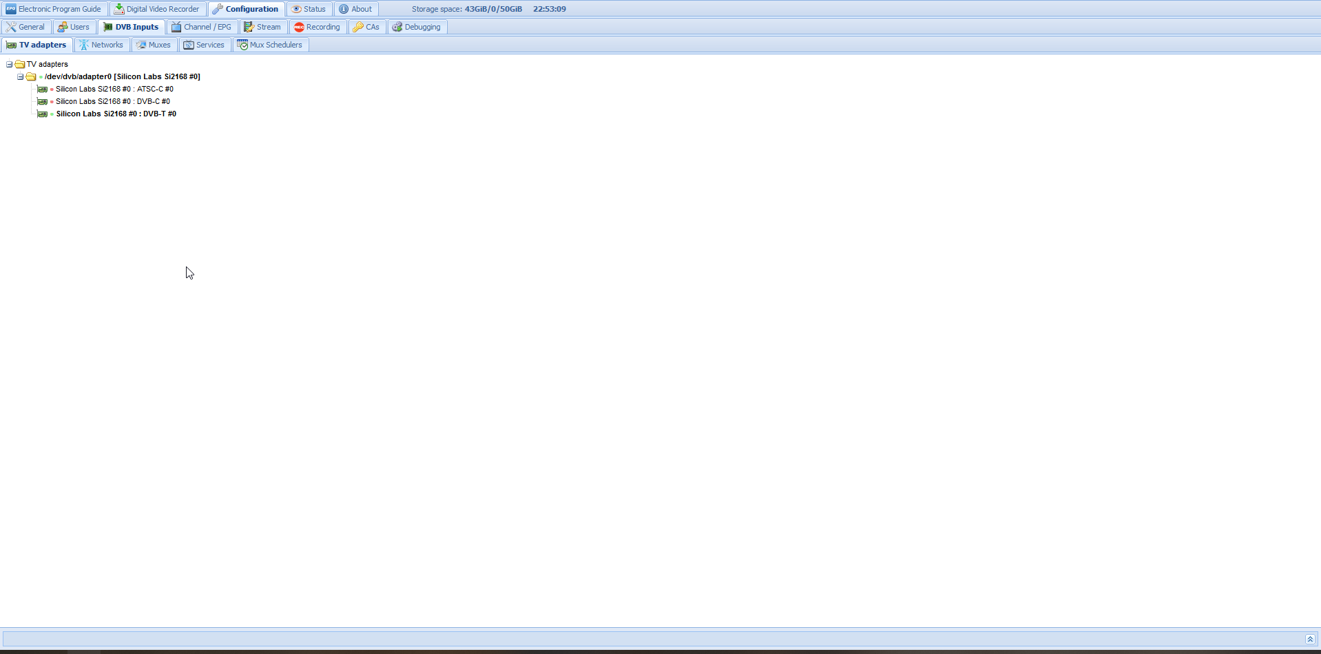

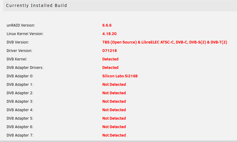

Im having trouble with getting DVB-T2 to work on TVHeadend or Plex, I am able to get DVB-T fine, but it doesnt appear to be detecting that my tuner (Hauppauge WinTV-soloHD) has DVB-T2.
Im running Unraid 6.6.6 and have tried the LibreElec build and the TBS-OS build but nither have any success in getting DVB-T2
dmesg: https://pastebin.com/WVPFdwVV
For me looks like it work ;) please send screenshot from Tvheadend - section - Tuners ....

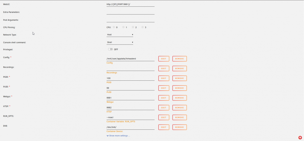

Post your TVHeadEnd docker run command
Here is a screen shot of the docker settings and a screen shot of the devices listed in TvHeadend
did you try add any mux for T2 ? and scan ? for me looks like work, there could be 2 other things, maybe different firmware you need or there are some special switch in driver module. but first try ... scan any T2 mux, because for me looks like work
I agree, drivers are loaded and device visible in TVH.
Sent from my Mi A1 using Tapatalk

so may describe 1 issue you want to solve now, dvb device wich has continue errors ? there may the author of tvheadend can help ...
has nothing to with this thread (just needed for drivers for unraid to make use of /dev/dvb ...)
Know i only have one issue, dvb device wich has continue errors on running on TVH inside libreelec VM are recognized at docker, but not scan.
It can't detect any signal, and i think this come from unRAID DVB Edition, because passtrounth to docker not works, and at VM tuner works.
I will try other drives from 6-6-6v2. I'm using (tbs-crazy-dvbst), and will report.
Thanks a lot for help me, and for this great work, unRAID DVB Edition ;)

I use DVBSky T330 with latest TVH docker and works fine...
What version of DVB edition you are runnnig?
6.6.6v2 above? And what release ( Libreelec, TBS or Crazycat)?
Thanks for your feedback, so here will work good to! Good News!
