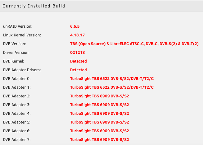

@piotrasd for me, libreelec still doesn't work 😞
im tested only tbs-os ...
