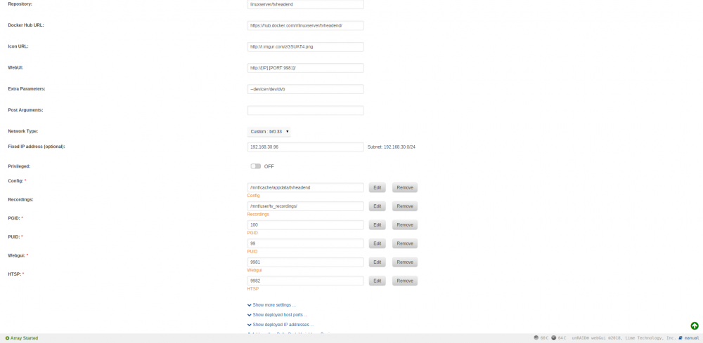

Hi mate
upgraded last night to the TBS Open source build and wife just told me tv not working.  I've checked and in TVH there are no cards showing - checked docker all still seems ok and the card is still in unraid, so don't think this is RC1 unraid's end:
5a9926f038d2b_FireShotCapture58-Highlander_UpdateContainer_-https___1d087a25aac48109ee9a15217a.thumb.png.4dedbb0eefc6527677c3378bbaf7dadb.png
IOMMU group 34:	[544d:6178] 07:00.0 Multimedia controller: TBS Technologies DVB-S2 4 Tuner PCIe Card
diagnostics attached if they help - I know you don't have a DVB card anymore to check yourself :-(
highlander-diagnostics-20180302-1027.zipKeep up the good work!

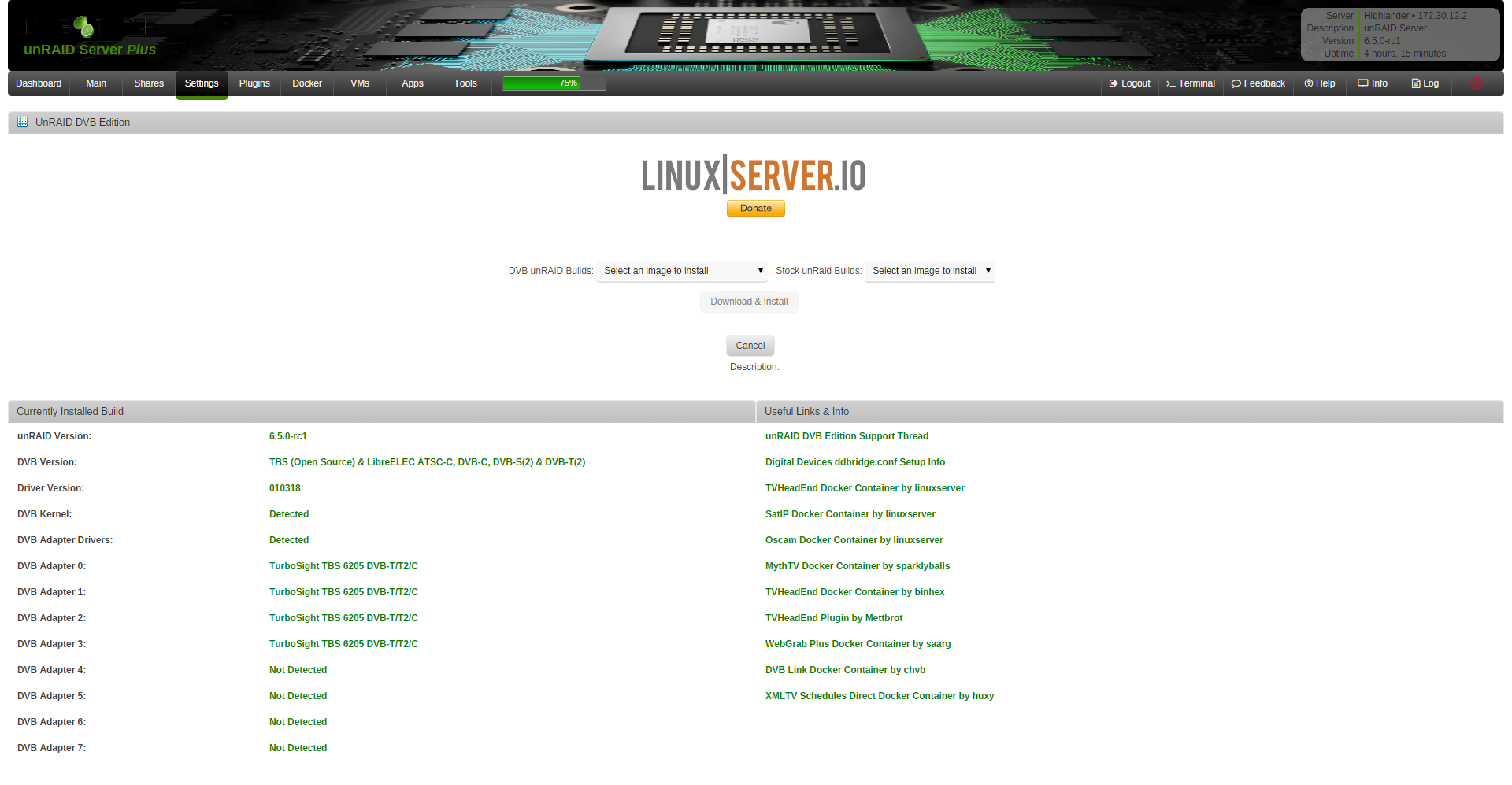

@DZMM All the information I need apart from the Unraid DVB plugin screen!  Can you post a screenshot?
I've just noticed it doesn't say 'DVB' in the top right -  didn't it used to?
5a99362c81346_FireShotCapture59-Highlander_UnraidDVB_-https___1d087a25aac48109ee9a15217a.thumb.png.b2976d7f494b801a466f6cfe8d6c4dbf.png
Not sure,
But it actually shows your tuners have drivers.
Not sure,
What drivers were you using before and what Unraid version?
