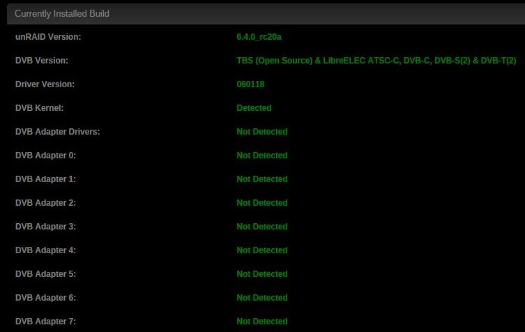

I don't know why but my TBS 6984 isn't detected in 6.4.0 RC versions of unRAID. I tested all releases from rc12 to rc20 without any luck, but in 6.3.5 everythig works perfect.
Anyone help?
Thanks.

Strange, it's included in the open source drivers. Can you post a screenshot of the UnraidDvb plugin screen please?
This is what I have:

@w^w
Can you try RC19 again, but replace the bzfirmware file with the attached one?
I have a theory...... :/
bzfirmware
If this works, I'll try and push out a RC21 tonight

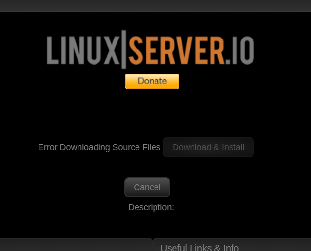

Will do, but I'm getting "Error Downloading Source Files" on the plugin at the moment.  I'm running 6.4.0.
Any ideas?
i can report, that at least my card was detected and TVH is recording now a few titles. can't tell though, if these are ok (at least i don't see any unusual error countings up to now).
Any ideas?
No fecking clue.....  try removing the plugin and reinstalling it.
That worked.  Somebody's Plexing at the moment, so I'll install later.

Ok, I found the issue.
Your card requires this firmware
I was pulling the firmware direct from TBS not from either of the above links, but when I compared the md5 on the version I was using, it was the "Windows" version, now I've replaced it with the "Linux" version.
Strangely enough I was getting the firmware from a TBS download that was for Linux firmware and all the other firmware in the pack works fine.  I've altered my script now to use the "Linux" version of the firmware. See here.
As you can see here, the firmware I was originally using for your card, came from a Linux download direct from TBS! No wonder it got confusing....,.
