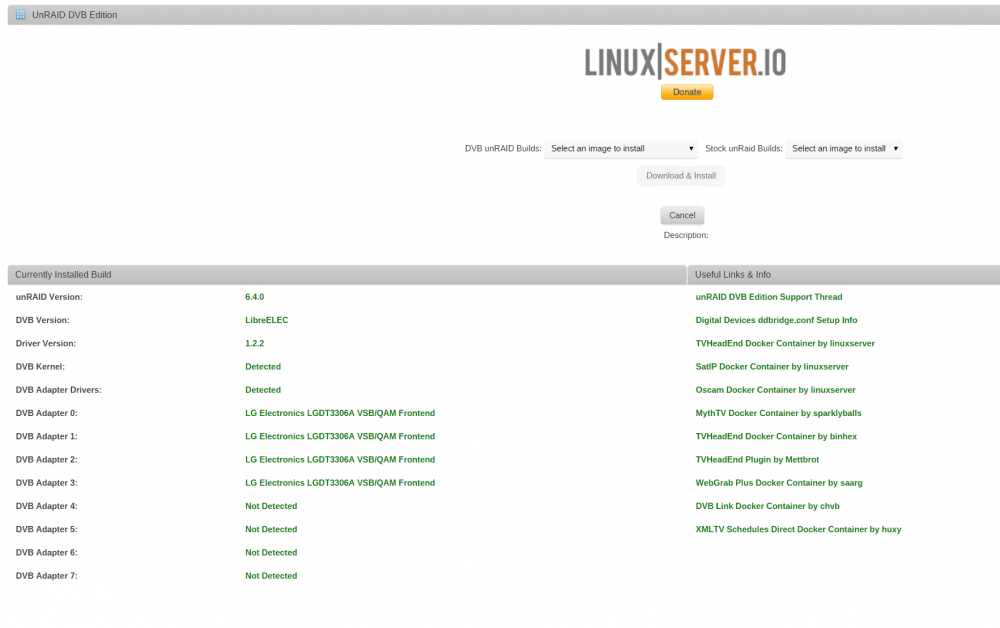

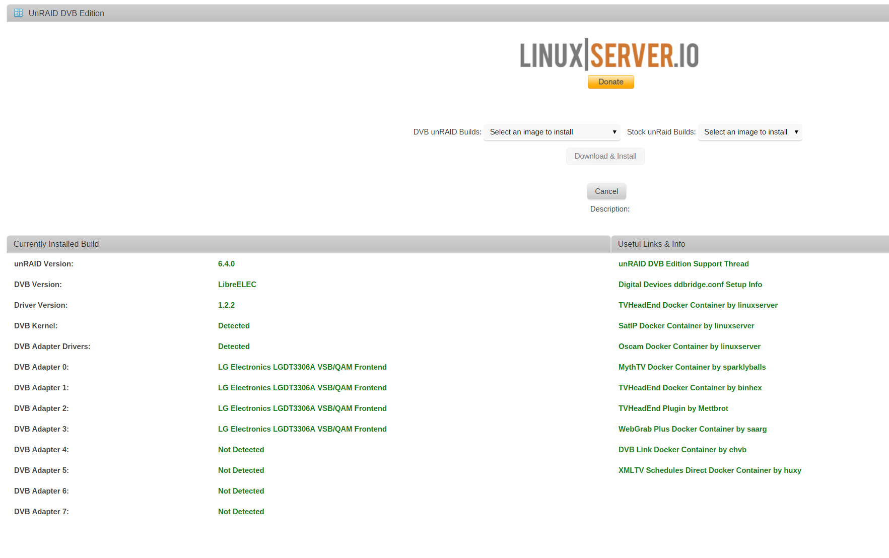

I was on 6.4.0 using Libre and my card was detected. Upgraded straight to 6.4.1 Libre (did not update to stock 6.4.1 first) and my card was not detected. Went back to 6.4.0 Libre and it is detected again.  HAUPPAUGE WinTV-quadHD PCI Express TV Tuner Card 1609   . On 6.4.1 it shows up not detected. Should I make sure to update to the stock 6.4.1 first then the Libre?
Can you try v6.4.1rc1 and v6.4.1rc2?  Help me troubleshoot.....
No need to go to stock once you're on v6.4.x
Edited by CHBMB
6.4.1 RC1 works, RC2 does not.
Below is what it looks like in rc2 and final.
Edited by hackztor
