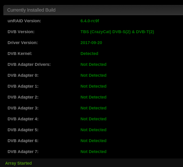

I've just tried using LibreElec 6.5.0-rc9f to see whether my TBS 6981 would show up, and it's showing two "Conexant CX24117/CX24132" adapters.
As expected, these are showing up in TVHeadend and not enabled.  Would it be possible/normal/advisable to rebuild my TVH config based on these inputs?  Are they likely to work?  Or should I be sticking to TBS builds?
TBS tuners needs TBS build. TBS drivers aren't in mainline kernel that LibreELEC is based on.
OK, fair enough.  Do you want me to go back through the RCs to see if there's a point at which it's recognised?  Do TBS not make an official driver for the current kernel (I hadn't used the OpenSource/CrazyCat versions up until now)?
TBS's official drivers are now the open source ones. They've stopped developing the closed source ones which haven't compiled correctly on any of the v6.4 rc builds.
I have emailed them about this to clarify and they confirmed the above.
By all means try an earlier build to see if that helps.
When I get some time I'll take a closer look.
OK, thanks for that :D

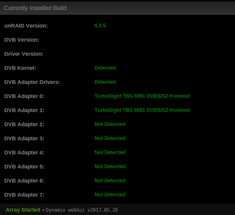

Can confirm that 6.3.5 open source finds my TBS 6981 card, but 6.4.0-rc1 doesn't.  Haven't tried rc2-8, but guessing it won't be promising.  I'll leave you to it with fingers crossed.  Thanks for your time.
Take a dump of the syslog for 6.3.5 and then find out what's missing, with regards to the TBS card, from the logs between 6.3.5 and 6.4.x
This is how I found out that my Hauppauge card wasn't being detected in the earlier 6.4.x builds by CHBMB, which to do with changes to cx23885 code in v4l.
Doing a "modprobe cx23885" in an unRAID ssh session then showed up a few errors that led to a resolution.
Thanks for that - I'm guessing that between TBS official, OpenSource, 6.3.5 and 6.4.0 I might be comparing apples to oranges, but I've been taking a look.
I've extracted what I think is the important part of 6.3.5's system log after a boot.  Contains all references to TBS, plus anything else surrounding that looked related.

...whereas all 6.4.0 opensource mentioned was this...

Thanks for that @CHBMB.  No joy I'm afraid...
unRAID Version: 6.4.0_rc10b
DVB Version: LibreELEC
Driver Version: 1.2.1
DVB Kernel: Detected
DVB Adapter Drivers: Not Detected
DVB Adapter 0: Not Detected
I'm absolutely stumped by this one, the firmware is in the LE version with the correct md5sum
Just on the off chance what does ls -la /dev/dvb/ give you?

Thanks for your time.  In 6.3.5 I get...
root@unRAID1:~# ls -la /dev/dvb/
total 0
drwxr-xr-x  4 nobody users   80 Oct 29 18:20 ./
drwxr-xr-x 18 root   root  4840 Oct 29 18:20 ../
drwxr-xr-x  2 nobody users  120 Oct 29 18:20 adapter0/
drwxr-xr-x  2 nobody users  120 Oct 29 18:20 adapter1/
I will try in LE shortly - somebody's streaming Plex at the moment...
