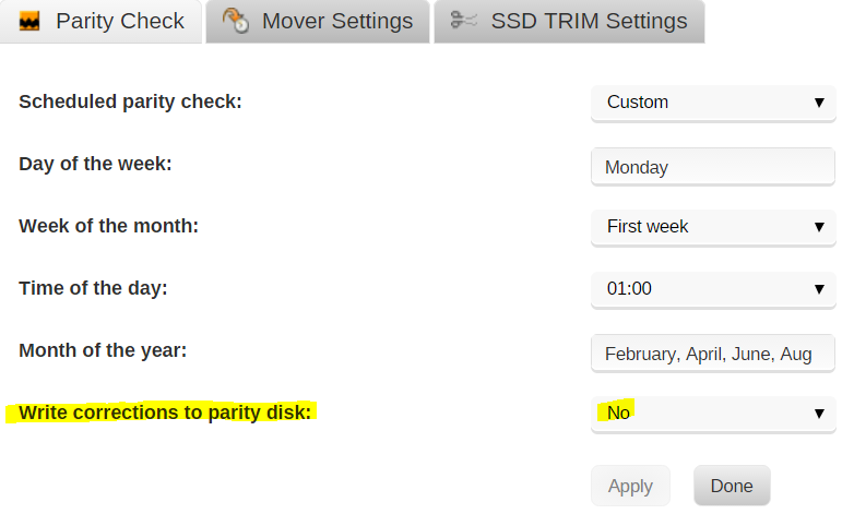

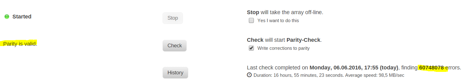

I just finished my scheduled 2-Month parity check and it came back with 60748078 errors...
I was one of the people who had trouble with the freezing server and the resulting hard-resets. I also reproduced theese freezes and tried my best to make sure all of my disks are indeed spun down before cutting power.
I was always wondering, because after rebooting, unraid never started a parity check, I was thinking it was due to my best efforts. I have not yet seen any corrupt data, not in or outside of any VM, so I think/hope, that the data was written correctly, but due to the lockup in the unraid driver, changes didn't make it to parity. No disks, parity or data, show any errors or SMART warnings.
While the lock-up were definitly annoying, I think not starting a partiy check when it should be is a more severe issue.
The other thing that may have something to do with it, I switched one of the disks from xfs to reiserfs and back again.
But I always moved every file to another disk before I took the array offline, changed the filesystem, started the array, and hit "format" in the gui. I think that should not invalidate parity or because its an easy task through gui, at least warn the user that it does and start a new parity sync?
However, the most concerning thing for me is, the scheduled parity check runs with "nocorrect" in case I need to manually check if parity or data is wrong.
With 60748078 errors and nocorrect, shouldn't parity be invalidated? it still states "parity valid"...
I am tempted to run a manual parity check with "write corrections", but I would be willing to run another "check only" If you think it helps to find the issue.
Last option would be, I am confused and everything is as it should be, but an explanation would be nice in that case :)
* The syslog unfortunately has been edited, and while it's OK to edit out the files moved, we really need the rest of the syslog.  If there's an issue, the 2 most important parts of the syslog are the part where the errors begin AND the initial setup, all of it.  If one of those are missing, then we have to speculate, can't do a very good analysis.  Your syslog is missing the entire beginning, so perhaps there's a syslog.1 or syslog.2 in /var/log?
* You booted some time on the 25th, but the syslog begins on the 29th, and very unfortunately there was some kind of kernel crash on the 28th, involving KVM.  It caused a registry dump in the KVM log, but it would be very useful to know what appeared in the syslog.  Once a critical event like that happens, I would never consider a system to be stable after that, and that makes everything that occurred after that suspect.  If you detect a kernel crash, of any kind, it's best to reboot, even if the system appears to have recovered.
* The unusual behaviors you mentioned do seem wrong, but since the system is 'suspect', there's not much we can conclude, as we don't know if it's truly from a bug, or just a corrupted system from the earlier 'crash' event.
* *If* all was fine with the system, then I would have to say that parity had never been built, as every single parity block was wrong, until logging was stopped.
