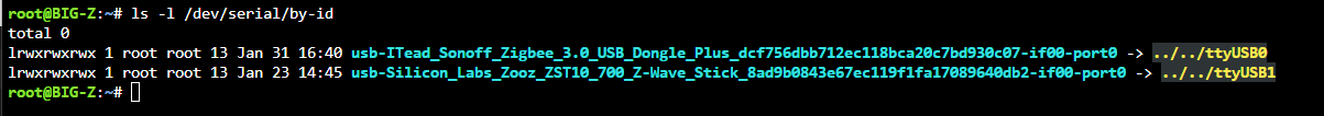

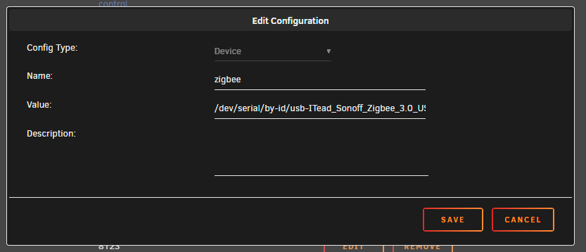

  • the best method to passthrough usb to docker is via device by-id open unraid terminal type  ls -l /dev/serial/by-id   you will get output of your devices with names

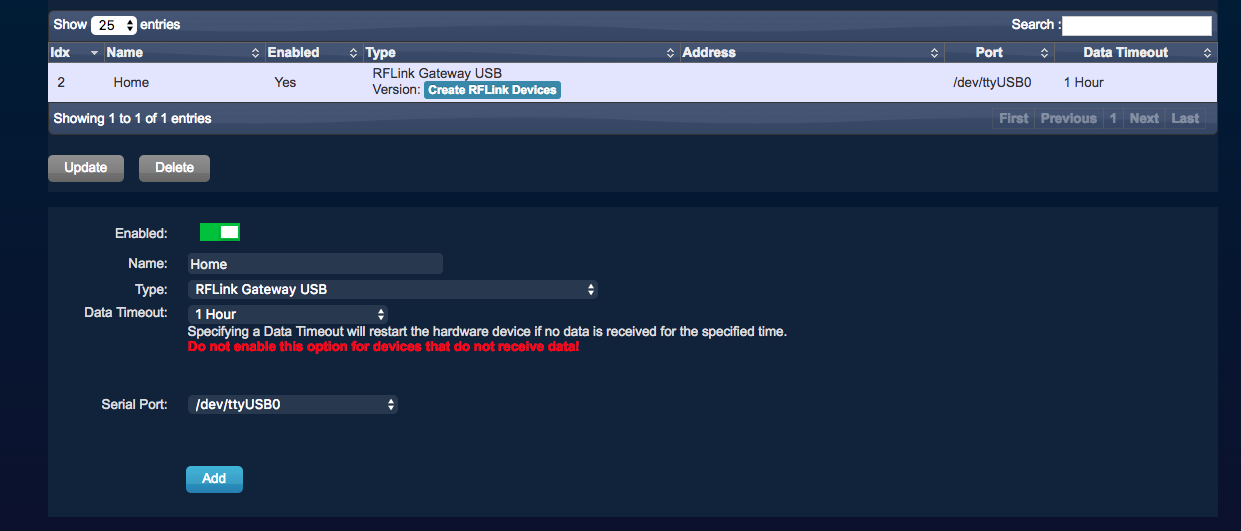

ah ok so i changed my config to - --device=/dev/bus/usb/001/005:/dev/ttyUSB0
After making that change i can now see an option in the port selection menu - "dev/ttyUSB0"
Is there anyway to check comms as i'm not sure it's working.
type
copy the whole BLUE name of your device
go to your docker and edit config
add /dev/serial/by-id/  before pasting the name from above.
eg
/dev/serial/by-id/usb-ITead_Sonoff_Zigbee_3.0_USB_Dongle_Plus_dcf756dbb712ec118bca20c7bd930c07-if00-port0
then add :/dev/zigbee to the end -  this is the container mount point
so you end up with this in your Docker Host config:
/dev/serial/by-id/usb-ITead_Sonoff_Zigbee_3.0_USB_Dongle_Plus_dcf756dbb712ec118bca20c7bd930c07-if00-port0:/dev/zigbee
if anywere inside your docker program it asks for the device location you would set it to :
/dev/zigbee
type
eg
I have the exact same device as your screenshot and am passing it through the exact same way (by the /dev/serial/by-id path) and it's still not registering in my docker app (Home Assistant). Any ideas why that would be? I've been pulling my hair out over this for a while.
At first I thought it was passing through correctly since "lsusb" output in the docker container included the device, but then I noticed that even when I wasn't passing it through explicitly in the unraid UI, lsusb still listed the zigbee dongle.
try adding :/dev/zigbee to the end of the VALUE
