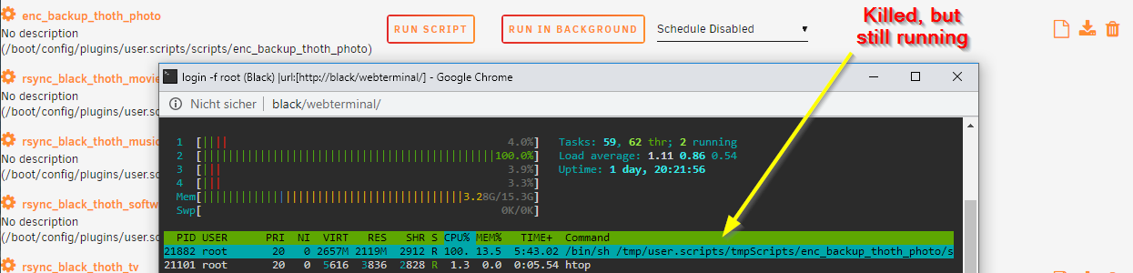

Maybe someone needs a script for file encryption:
Yes it does.  However, any long-running processes spawned by the script will run to completion.  (ie: your rsync)
My script contains a loop of different short running processes (mkdir, openssl, touch) and not one long running single process. If I close f.e. the "Run Script" window it is killed completely (as expected).
Edited by mgutt
