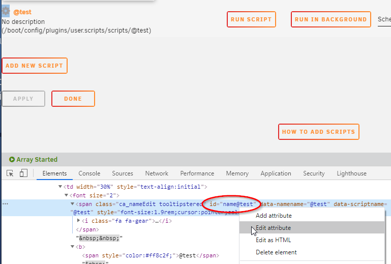

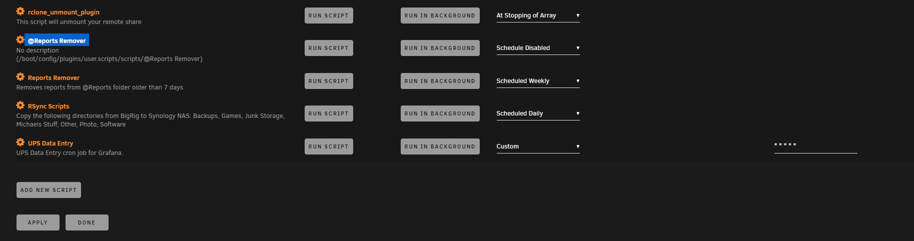

I have been using User Scripts with no problem for a long time. I tried to modify the timings of my some of my tasks, and APPLY and DONE does nothing. The button is clicked, but no action is taken and refreshing the page leads to old settings. Not working in chrome, IE or Firefox.
How can i save my updated changes.
NOTE: I also have one user script with an @ in the title and the cog is completely unclickable, not sure if this is related. If i could remove that too would be great.
bigrig-diagnostics-20200815-1326.zip
Edited by mihcox
Check the browser developer tools (F12 -> Console in Chrome). I bet there are javascript errors listed.
Errors appear related to the @Reports... How can i manually remove this, as the gui does not respond when i click on it.
I tried it by myself. You can bypass this error by right mouse click -> inspect element and then remove the "@" symbol of the "id" attribut as shown in this screenshot (so it becomes id="nametest")
After that the cog works and you are able to delete this script (and add a new one without the @ symbol in the name).
Resolved both issues, thank you!
