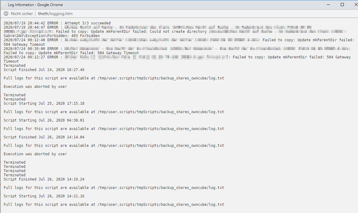

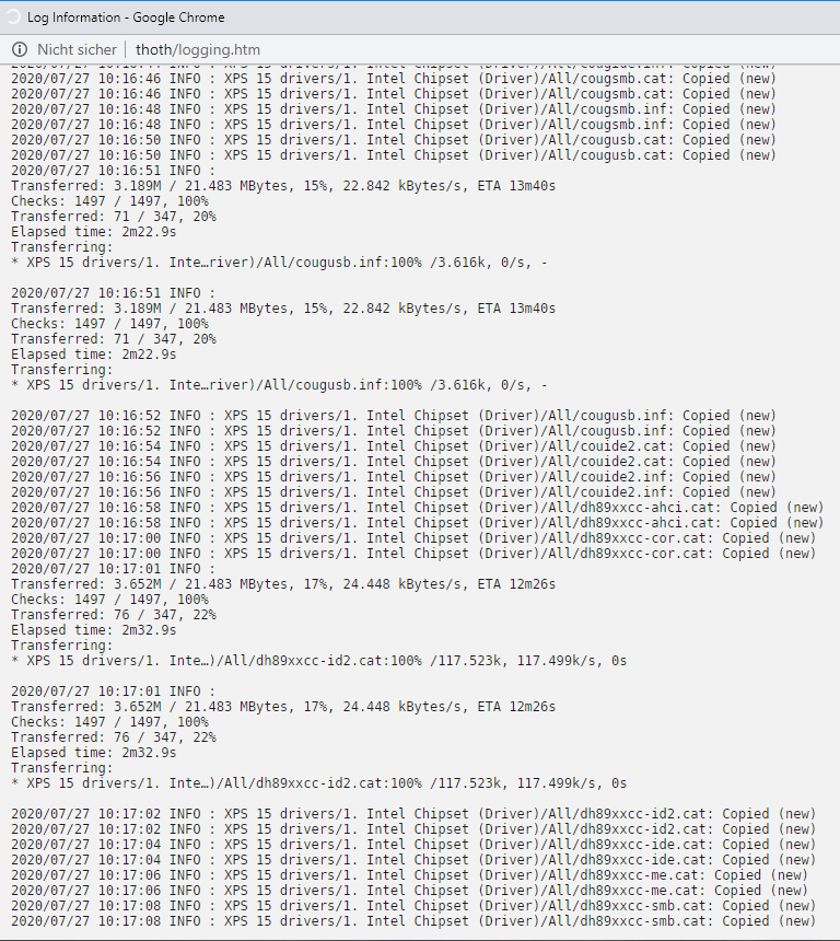

11 minutes ago, Squid said:
It already does that
Does not work for me. rclone is running and the logs are "empty":
"vi /tmp/user.scripts/tmpScripts/backup_shares_owncube/log.txt" returns the same.
Redirect the output of the command something like
rclone ....... >> /tmp/user.scripts/tmpScripts/backup_shares_owncube/log.txt
This would make the scripts to complicate and it's not easy to use / share them on multiple platforms.
EDIT: Ok, found a solution that is more portable and works for all unraid scripts:
exec > >(tee --append --ignore-interrupts $(dirname ${0})/log.txt) 2>&1
This needs to be put in the first line after "#!/bin/bash" and now all command returns and echo's are logged!

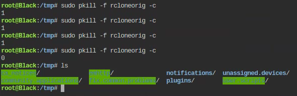

Although my last test returned the opposite, I found out that CA user scripts is not race condition safe. So I changed my script as follows:
#!/bin/bash
# kill all commands on exit
function exitus() {
    exit_status=$1
    sudo pkill -f rcloneorig
    sleep 1
    sleep 1
    sleep 1
    sleep 1
    rmdir "/tmp/${0///}"
    exit $exit_status
# make script race condition safe
if [[ -d "/tmp/${0///}" ]] || ! mkdir "/tmp/${0///}"; then
    exit 1 # do not use exitus here or it will kill the already running script!
fi
trap 'exitus 1' EXIT
# logging
# rclone
rclone copy /mnt/user/software owncube:software --create-empty-src-dirs --ignore-checksum --bwlimit 3M --checkers 2 --transfers 1 -vv --stats 10s --min-age 3d
rclone copy /mnt/user/music owncube:music --create-empty-src-dirs --ignore-checksum --bwlimit 3M --checkers 2 --transfers 1 -vv --stats 10s --min-age 3d
rclone copy /mnt/user/movie owncube:movie --create-empty-src-dirs --ignore-checksum --bwlimit 3M --checkers 2 --transfers 1 -vv --stats 10s --min-age 3d
rclone copy /mnt/user/tv owncube:tv --create-empty-src-dirs --ignore-checksum --bwlimit 3M --checkers 2 --transfers 1 -vv --stats 10s --min-age 3d
Then I pressed "Abort Script", waited 10 seconds and checked if my tmp dir is still existing and it does:
A short check with top confirmed that the rlconeorig process is still active.
So I killed rclone as follows:
As you can see I needed to kill every rclone command separately and you can see that "rmdir" of my script has been executed as my atomic dir "tmpuser.scriptstmpScriptsbackup_shares_owncubescript" is gone.
Conclusion: The "Abort Script" button does nothing except removing the "Running"-status in the webclient. The script itself runs until the end.
Edited by mgutt

54 minutes ago, Squid said:
But was the script itself still running?
Yes. I proved it in my post. The script contains 4 rclone commands. After I aborted the script through the GUI it does not kill the running rlcone process and I need to kill every following command separately (the first rclone command was already finished, so I needed to kill only 3):
(The "-c" flag returns the amount of processes that were killed)
And after I killed the last rclone process it executes the very last line of the script, too (the rmdir command).
This proves that the script is still running (and not only one long process).

I tried many commands and by that I found out that pkill does not kill (all) child processes:
root@Thoth:/tmp# pgrep -f isleep2m | xargs --no-run-if-empty ps fp
  PID TTY      STAT   TIME COMMAND
19608 ?        SL     0:00 /usr/bin/php /usr/local/emhttp/plugins/user.scripts/startBackground.php /tmp/user.scripts/tmpScripts/isleep2m/script
19609 ?        S      0:00  \_ sh -c /tmp/user.scripts/tmpScripts/isleep2m/script  >> /tmp/user.scripts/tmpScripts/isleep2m/log.txt 2>&1
19610 ?        S      0:00      \_ /bin/bash /tmp/user.scripts/tmpScripts/isleep2m/script
root@Thoth:/tmp# pkill -9 -P 19608
19610 ?        S      0:00 /bin/bash /tmp/user.scripts/tmpScripts/isleep2m/script
