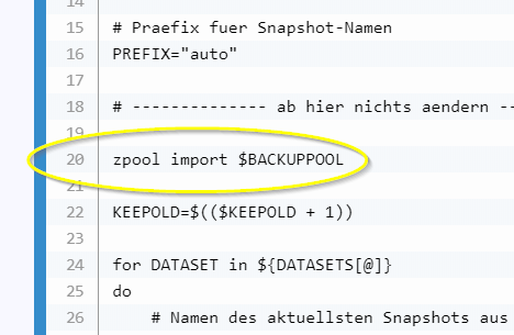

Hello there,
i found a realy great script for my (ZFS) Backup purpose.
Unlucky me i have no clue about scripts % Co. I am still a noob and would like to know if somebody can help me to fix the errors / mistakes
the script came from here https://translate.google.com/translate?hl=de&sl=auto&tl=en&u=https%3A%2F%2Fesc-now.de%2F_%2Fzfs-offsite-backup-auf-eine-externe-festplatte%2F%3Flang%3Den
after several try and error i must gave up and pray somebody can help me : line 21: dialog: command not found
anyone ?

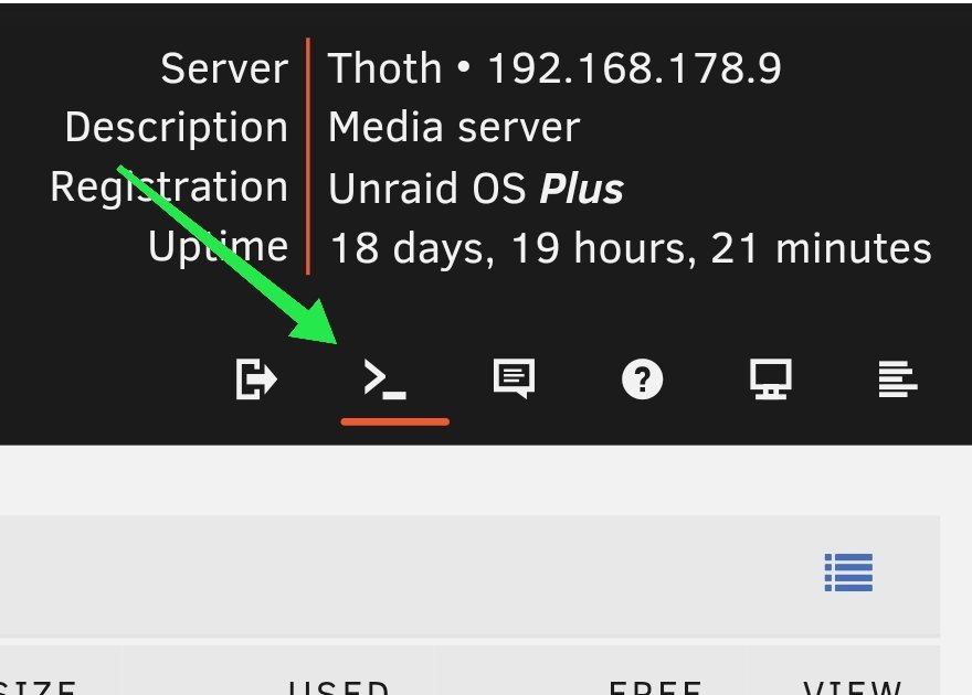

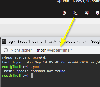

@Dtrain
Around line 21 is the command "zpool":
This command is part of the zfsutils package and not available by default on an Unraid server. Maybe this is the reason? Test it by yourself. Open the terminal and type in "zpool":
If it returns "command not found" than you need to install the ZFS Utilites first.

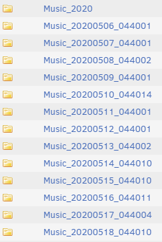

This creates backups as follows:
Every folder contains the full 1:1 backup of its day, but as "--link-dest" creates only hardlinks for already existing files it physically copies only changed / new files. This means its saves as much space as a ZFS snapshot does.

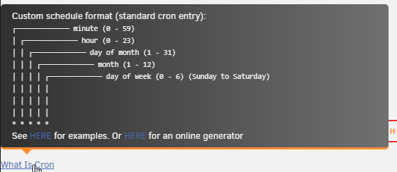

It would be nice to have a user-friendly input for the custom cron schedule or even an explanation.
This answer helped me to understand the syntax.
EDIT: Ok, now I found the "What is Cron" at the bottom of the page. Maybe you should rename it or add this popup after the "Custom Cron Schedule" gets focus.
Unfortunately, a cron generator is way outside the scope of the plugin, and a manual entry would still be needed anyways to handle the very weird entries that are possible.  But if I remember, next update I'll move the "what is cron" link to someplace more visible.
I wish I'd seen that before!  Could never remember which "version" of cron was supported.  Have generated valid but incompatible schedules several times.
If realized in JS f.e. through a Pop-up, it  could only fill the field. By that it would be still possible to manually edit it. Could you send me the source code of the list page? I'll try to realize that.
