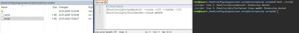

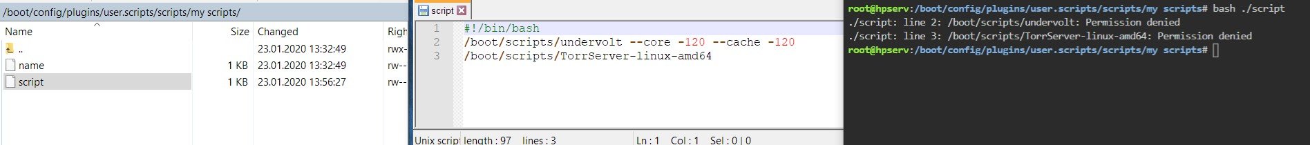

bash does not help me. what i'm doing wrong?
Because your script is trying to execute /boot/scripts/undervolt.  You script needs to execute bash /boot/scripts/undervolt
