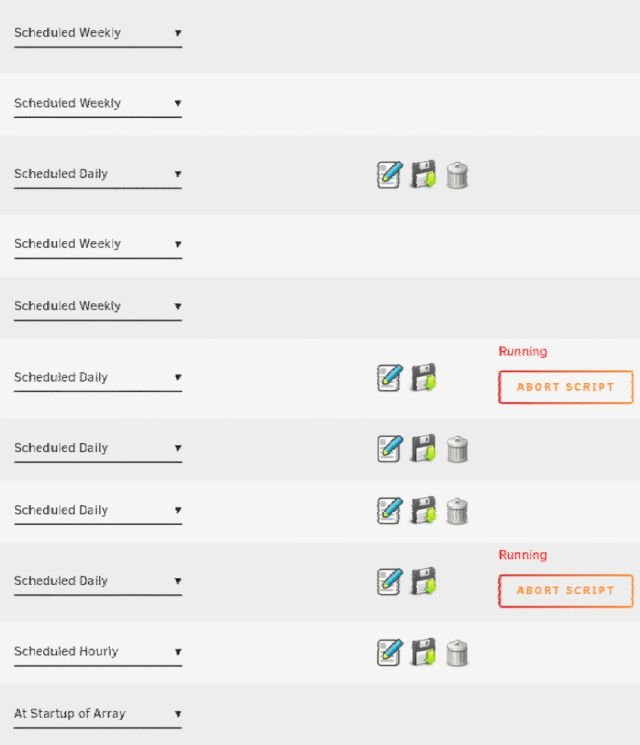

After many months of usage, I realized today, that the user scripts seem to run in parallel (see image attached).
As I do have scripts that need to run after each other, how can I force that?
Many thanks in advance.
Have a single script that runs and calls each sub-script in turn
So I build my own Daily, Weekly, Hourly scripts?
Ah, I see. Thought User Scripts would work that way. Will do it.
NowI do understand why my M.2 NVMs report high temperatures in the night. No good idea to start approx. six daily scripts at once.
Thanks.
Edited by hawihoney
I think it's more that you create and schedule one script, and that script calls all the others one after another.
Or you could apply a custom schedule to your scripts and have them run - say - 30 minutes apart.
I did use User Scripts because I was under a wrong Impression. I thought if there are catagories (Daily, ...) the Plugin would call all Scripts of the same category in order - one after another and not all at once.
BTW, why would one call a bunch of Daily Scripts at once?
Probably because I'd then be inundated with requests to specify an execution order [emoji6]
That, and people are leveraging this plugin to do things I never considered.
