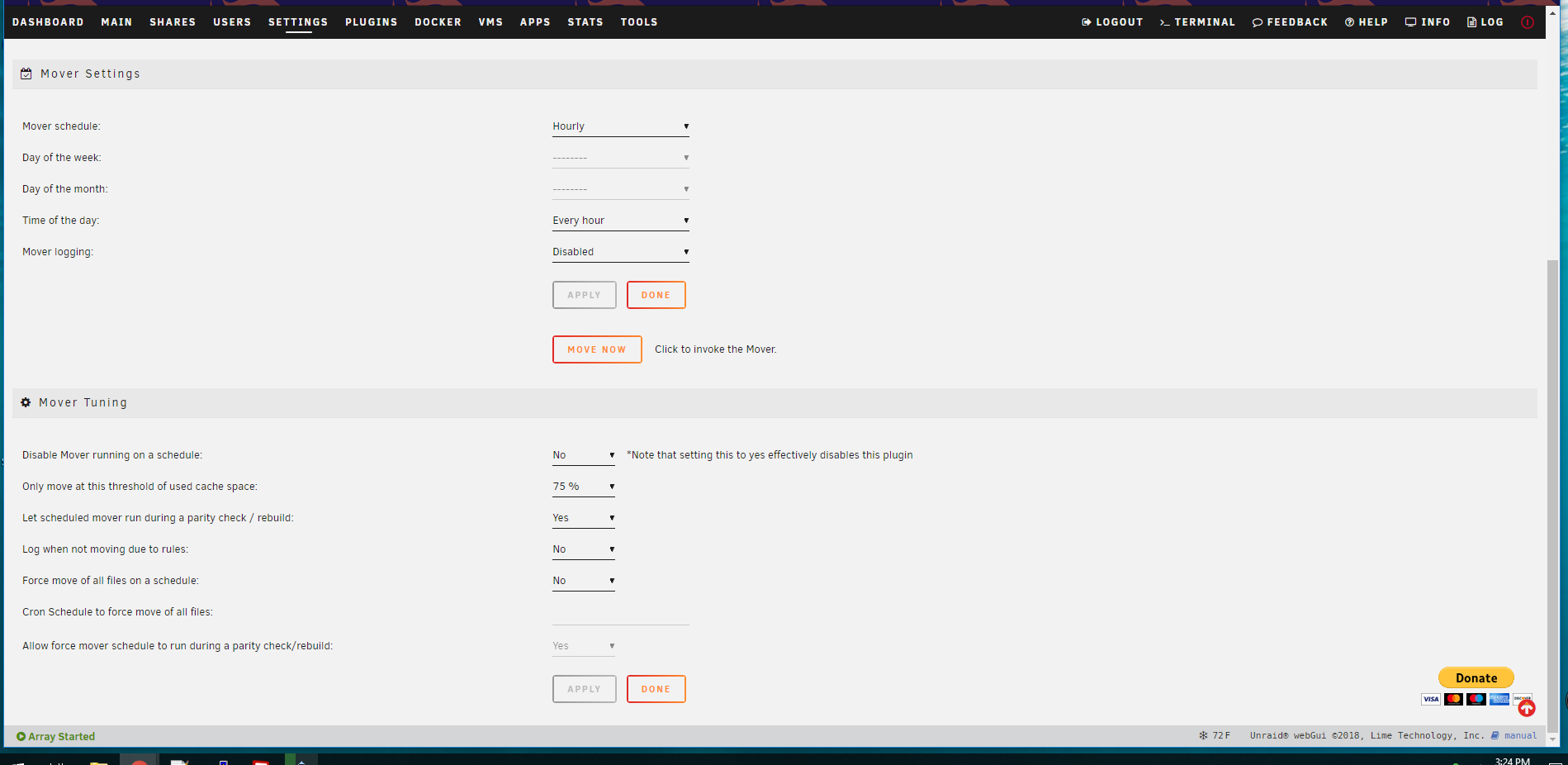

3 minutes ago, scubieman said:
dont see it
Scroll down some more.

You see by the scroll bar I am to the bottom.
You need to install the dynamix Schedules plugin to be able to adjust the Daily/Weekly/Monthly times
That works better. Thank you!
