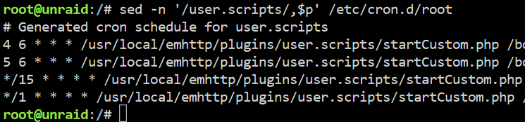

Afternoon All, I seem to be unable to "apply" settings (the apply button doesn't do anything) or view logs of previously run scripts.
I've tried a couple of browsers, on a couple of devices, any idea what might be going on?
Thanks
Hi karldonteljames
I think you forgot the space (*/15****) -> (*/15 * * * *). I hope i see that right..
(No, I think you wrote that correctly in the field.)
After you have entered the cron in the field, press Enter and then klick apply.
You can check the entrys after apply with this command:
sed -n '/user.scripts/,$p' /etc/cron.d/root
(/etc/cron.d/root)
I hope you can confirm this.
Greetings
Edited by Amane
Thanks, That's just it. Clicking apply doesn't do anything. No Loading, no being greyed out, nothing so far as I can tell.
After running that command line (above) nothing changes on the crown file.
I'm also missing the icons to view the logs of the completed scripts too.
I've even restarted Unraid a couple of times.
Edited by karldonteljames

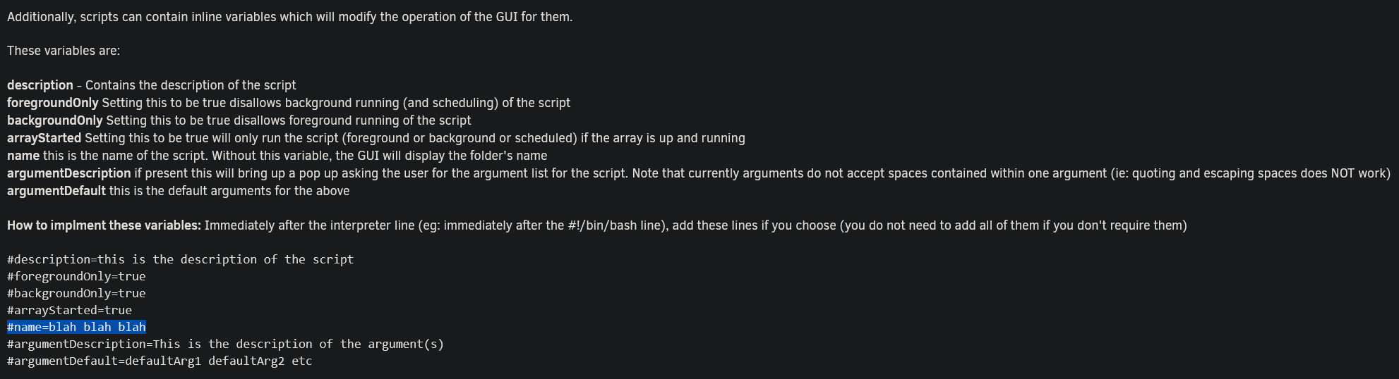

Does the author of this script read the posts here, or is that just slapping the wind? Or where can I contact the developer of this script?
On 4/23/2024 at 10:04 PM, Luanas said:
Hello. After renaming the name of the script in the section where user scripts are located, the file is not renamed and the original name remains.
Do you can fix it, please?
The plugin is not created so that it renames the folder in which the script is located (/boot/config/plugins/user.scripts/scripts/)
If you want to rename the script or rather the folder in which the script is located, you must recreate the script with the same content and use the correct name from the beginning.
Does that help you?
Can you apply the other options correctly?
