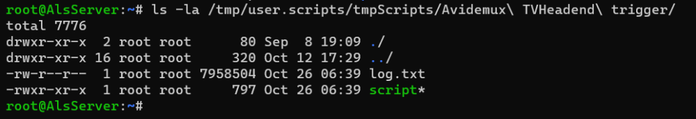

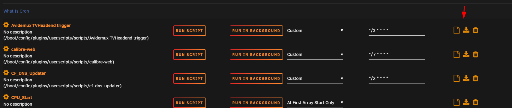

Where do I find "/tmp/user.scripts/tmpScripts/Backup" in order to view my rsync logs? Sorry to ask such a basic question, but I have searched the unRaid forums without an answer
you should see your logs on the user scripts page
if you manually want to copy them over
they are located in Ram ...
so a cp ..../log.txt /mnt/user/whereever ... will copy them to a persistent storage.
