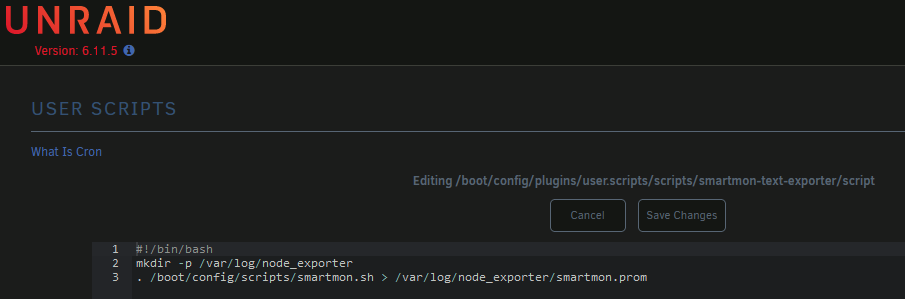

Could you be convinced to add a variable to pipe stdout to a specific path?
My target: prometheus_node_exporter contains a textfile collector.
There are a handful of community scripts designed to
- be run from cron (ie your plugin on a custom schedule)
- collect useful (I'd argue critical) system metrics (ie smartmon stats like temps and failure indicators) for prometheus-node-exporter
- output data to stdout, to be piped to a file
The inconvenience is, to use these is not straightforward. They would require extensive modification most users can't grok.

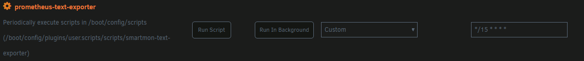

Thanks to your plugin, an alternative is to manually save them to disk someplace, then use your plugin to write a script which runs them with stdout piped to a file, scheduled cron-alike.
EDIT: These are the same script, ignore the name difference I used an old screenshot for the one by mistake
This is workable but some users may still find this unapproachable.
If the user could paste the entire script (in my case, /boot/config/scripts/smartmon.sh aka smartmon.sh [raw] among others) into a User Script, schedule them as cron-alikes, and mark their output to be sent to a specific path, it would make these more approachable.
It could be implemented similar to the variables you've recently added; an STDOUT variable could be changed to request redirection.
Regardless of your decision, keep up the great work. The plugin has been quite valuable for many of us!
