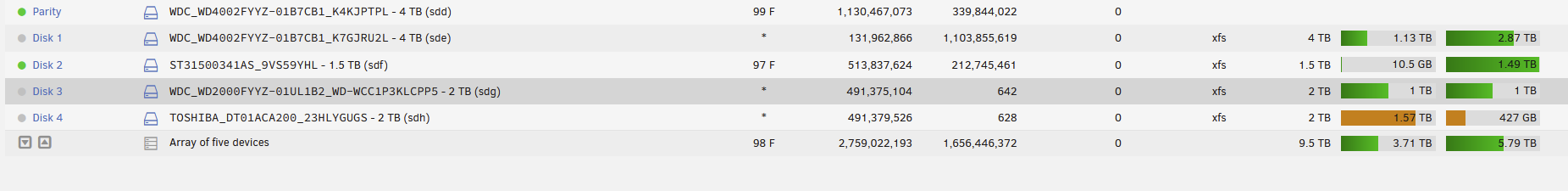

I am running the "clear an array drive" script on a 1.5tb drive.  I am only writing at around 5.2 MB/s, this has been running about 12 hours so far and appears that it will be running for a good while.  I see that it is not the fastest script, but is this about right?  BTW, running 6.11.5.

So, if I am reading my screen correctly... the script that zeros a drive is not slow, it is almost not worth trying.  I have been running almost 48 hours at this point and if I am reading correctly I have only cleard 200 mb of 1.5 tb.  Am I correct?  If so, I think I will just rip the empty drive out and unassign it and do the darn parity rebuild as all of my remaining drives are in good condition.

If you stop the array and start it again, the drive will show as unmountable, and the dd command issued at the console will go at full speed, probably several hours at most to finish.
If you want to do that, post back with a screenshot of the main array started and showing the drive assignments, and your proposed command line from the "alternate" section of the shrink array wiki page. That way we can double check that you are indeed going to clear the correct drive and not permanently erase one of your other drives, which would be very sad. Note that since the drive will already be unmounted when you restart the array you can omit the umount part and just do the dd line.

It appears that the following command would be issued from the cli since disk 2 is the one I want to remove:
dd bs=1M if=/dev/zero of=/dev/md2 status=progress
Thanks
Looks good, assuming after the array is stopped and started again disk2 shows unmountable as predicted.

So, how long should it say stopping array, sync filesystems. ?
Did you kill the original script? You may need to manually kill it using htop at the console.
I did kill the zero script in the gui, and it said it aborted.  Will look at htop from the shell.
So with ps -aux | grep zero from the shell I see this...
root@Tower:~# ps -aux | grep zero
root      6211  0.0  0.0   4048  2232 pts/0    S+   20:56   0:00 grep zero
root     21434  0.1  0.0   3636  2460 ?        D    Jun12   4:50 dd bs=1M if=/dev/zero of=/dev/md2
If I am not mistaken the "D" indicates that the process is dead but not gone?
should I kill process 21434?
tower-diagnostics-20230614-2101.zip
Edited by mattw
added diag.
So kill -9 21434 allowed the stopping array to progress to stopping array - unmounting disks.
Current dead processes...
root@Tower:~# ps -aux | grep D
USER       PID %CPU %MEM    VSZ   RSS TTY      STAT START   TIME COMMAND
root        51  0.0  0.0      0     0 ?        S    Jun11   0:00 [irq/24-AMD-Vi]
root     11701  2.3  0.0      0     0 ?        D    Jun12  68:59 [kworker/u8:0+flush-9:2]
root     19703  0.0  0.0   2676   116 ?        S    14:42   0:00 /usr/sbin/avahi-dnsconfd -D
root     28751  0.0  0.0   4048  2296 pts/0    S+   21:25   0:00 grep D
root     30160  0.0  0.0   3296  1148 ?        D    21:11   0:00 umount /mnt/disk2
My gut now tells me to kill 30160.
From system logs:
Jun 14 21:11:33 Tower emhttpd: Unmounting disks...
Jun 14 21:11:33 Tower emhttpd: shcmd (680076): umount /mnt/disk1
Jun 14 21:11:34 Tower kernel: XFS (md1): Unmounting Filesystem
Jun 14 21:11:37 Tower emhttpd: shcmd (680077): rmdir /mnt/disk1
Jun 14 21:11:37 Tower emhttpd: shcmd (680078): umount /mnt/disk2
It appears to be stuck unmounting disk 2.  That was the last log entry short of me opening an ssh session.
Open files plugin reports no open files.
Edited by mattw
Fix formatting
Ok, I feel like a dumb-ass!  I only clicked done in New Config the first time... done has always seemed to me that it should do everything in one shot, it does not!  The array is up and the disk I wanted to remove can now be remove.
Thanks much @JonathanM, I always get nervous when my array is in an odd state.
You let parity rebuild, correct?
