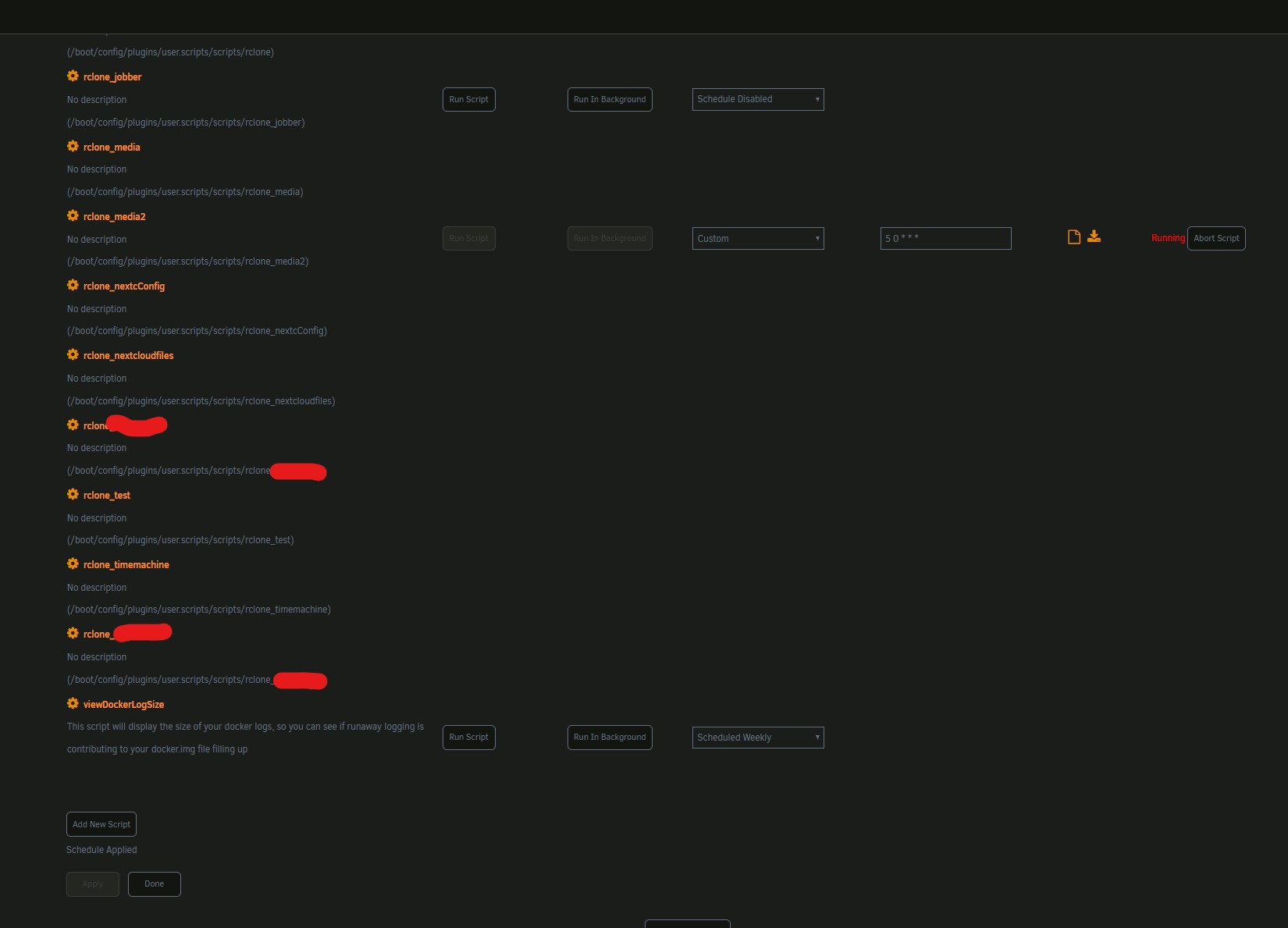

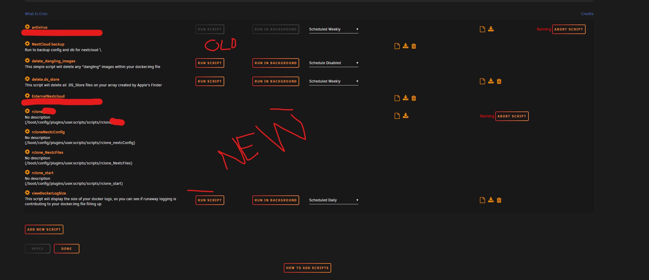

Hi, just noticed that all my custom cron scheduling is gone, is this a know issue with a known solution? All scripts with blank space next to it should have a cron statment.
And then i refreshed the "_media2" script also lost its settings.
Seeing this behaviour on a different instance of unraid. Ha less scripts there, and it had just messed with the custom cron. But when i add new scripts i loose the timecontrols. Any help?bilde.thumb.png.940946cb2173223b26bbc78b0d5ca450.png
Do those scripts have #foregroundOnly =  in them?
Remove that line if you're not using foregroundOnly.

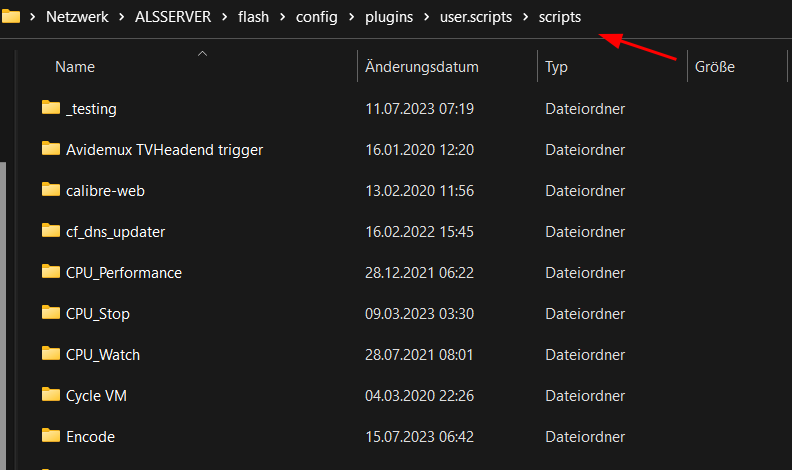

hi
i start running scripts for mounting my google drive and I did some modification after delete the old one and add new one and also reboot unraid but still getting Exiting script as already running
how to find old script and stop it ?
may take a look at your flash drive
delete userscript folder still same issue
and rebootet ?
you wont kill any running processes like this, its just a info where the scripts are stored ...
if i wanted to kill a running process now, i would look for the process and try to kill them
