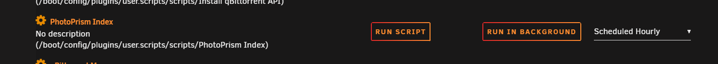

HI and thanks for this!
I tryed making a script with this:
"#!/bin/bash
docker exec PhotoPrism photoprism index --cleanup"
But it dosent run?
I tryed running it and it run fine?
Log:
Script Starting Dec 07, 2023 21:47.01
Full logs for this script are available at /tmp/user.scripts/tmpScripts/PhotoPrism Index/log.txt
time="2023-12-07T21:47:03+01:00" level=info msg="Become a member today, support our mission and enjoy our member benefits! 💎"
time="2023-12-07T21:47:03+01:00" level=info msg="Visit https://www.photoprism.app/membership to learn more."
time="2023-12-07T21:47:03+01:00" level=info msg="indexing originals in /photoprism/originals"
time="2023-12-07T21:47:03+01:00" level=info msg="classify: loading nasnet"
time="2023-12-07T21:47:06+01:00" level=info msg="classify: loading labels from labels.txt"
time="2023-12-07T21:47:06+01:00" level=info msg="index: found no .ppignore file"
time="2023-12-07T21:47:06+01:00" level=info msg="metadata: 20230415_161418.jpg has time offset UTC+2 (exiftool)"
time="2023-12-07T21:47:07+01:00" level=info msg="metadata: 20230805_103958.jpg has time offset UTC+2 (exiftool)"
time="2023-12-07T21:47:07+01:00" level=info msg="media: created 11 thumbnails for 20230415_161418.jpg [971.776134ms]"
time="2023-12-07T21:47:08+01:00" level=info msg="faces: loading facenet"
time="2023-12-07T21:47:08+01:00" level=info msg="media: created 11 thumbnails for 20230805_103958.jpg [1.020408965s]"
time="2023-12-07T21:47:08+01:00" level=info msg="media: 20230805_103958.jpg was taken at 2023-08-05 10:39:59.053 +0000 UTC (meta)"
time="2023-12-07T21:47:09+01:00" level=info msg="index: found 1 face in 20230415_161418.jpg [1.279918588s]"
time="2023-12-07T21:47:09+01:00" level=info msg="media: 20230415_161418.jpg was taken at 2023-04-15 16:14:18.455 +0000 UTC (meta)"
time="2023-12-07T21:47:12+01:00" level=info msg="index: added main jpg file 20230805_103958.jpg"
time="2023-12-07T21:47:12+01:00" level=info msg="index: matched 2 labels with 20230415_161418.jpg [3.373451468s]"
time="2023-12-07T21:47:12+01:00" level=info msg="index: added main jpg file 20230415_161418.jpg"
time="2023-12-07T21:47:12+01:00" level=info msg="index: updated 2 files [8.609189675s]"
time="2023-12-07T21:47:12+01:00" level=info msg="cleanup: removed 0 index entries and deleted 0 sidecar files [354.405µs]"
time="2023-12-07T21:47:12+01:00" level=info msg="cleanup: searching for orphaned cache files"
time="2023-12-07T21:47:12+01:00" level=info msg="cleanup: deleted 19 files from cache [2.639866ms]"
time="2023-12-07T21:47:12+01:00" level=info msg="cleanup: deleted 19 files in total [4.660941ms]"
time="2023-12-07T21:47:12+01:00" level=info msg="indexed 7 files in 8.657699195s"
Script Finished Dec 07, 2023 21:47.12

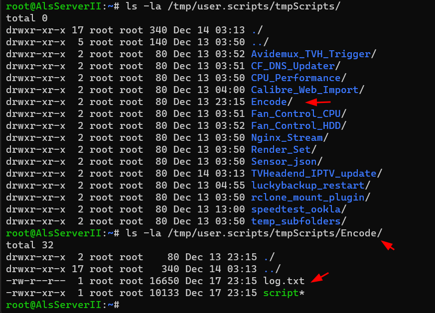

Hi All,
just discovered this awesome plugin and messing around with automating stuff.
terribly sorry for being extremely noob but how do i find this folder:

So, are the user scripts processed by a script?
I would like to modify the processing so that instead of log.txt the file name would be something like...
user_script_name_timestamp.txt
This would allow the log to be downloaded or stored as a unique file.
Thanks.
they are processed by the internal cron i would say, but about the logs ...
either webui, or if you want to process them manually
sample
it is unique for each script, not for each run ... (which i personally abolutely wouldnt want ...)
sample
I understand that but what I would like would look like…
log.Encode.timestamp.txt
If I download log.txt from multiple scripts that run, the download directory winds up full of stuff like log.txt, log1.txt, log2.txt…. Names are not tied to the script they came from.
Hi everyone,
very nice plugin, I only have a problem with the 'Run in background' with scheduled hourly option. It starts, but stops after a few seconds. The log file says only script finished. The script itself is just a oneliner to sync a folder with rclone encrypted to onedrive.
When I click 'Run Script', it runs as expected and all files and folders are encrypted copied to onedrive.
Where is my mistake?
unraid 6.12.6
Thanks for your help.
