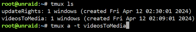

On 4/1/2024 at 9:31 AM, Dukobpa3 said:
Can I join to running script session somehow?
Use tmux 😉
#!/bin/bash
# Start with TMUX
SESSION_NAME="$(basename "$(dirname $0)" | sed 's/ //g')"
export TERM=xterm-256color
if [ -z "$TMUX" ]; then
    if [ $(tmux ls 2> /dev/null | grep "$SESSION_NAME" | wc -l) -gt 0 ]; then
        echo "Attach to exist TMUX-Session: $SESSION_NAME"
        tmux send-keys -t "$SESSION_NAME" "$0" C-m
    else
        echo "Create a new TMUX-Session: $SESSION_NAME"
        tmux new-session -d -s "$SESSION_NAME"
    fi
fi
your script here..
Then you can show your scripts and attach to a session:
Thats my variant..
If you have problems with tmux and 256-color settings (until the restart) :
grep -q 'set -g default-terminal "xterm-256color"' ~/.tmux.conf || sed -i '1iset -g default-terminal "xterm-256color"' ~/.tmux.conf
grep -q 'export TERM=xterm-256color' ~/.bash_profile || echo -e '\nexport TERM=xterm-256color' >> ~/.bash_profile
. ~/.bash_profile
For permanent workaround, you must add the following to the go file (/boot/config/go) :
# TMUX 256-color workaround
echo -e '\n# TMUX 256-color workaround' >> /root/.bash_profile
echo 'export TERM=xterm-256color' >> /root/.bash_profile
# TMUX configuration
echo 'set -g default-terminal "xterm-256color"' > /root/.tmux.conf
Edited by Amane

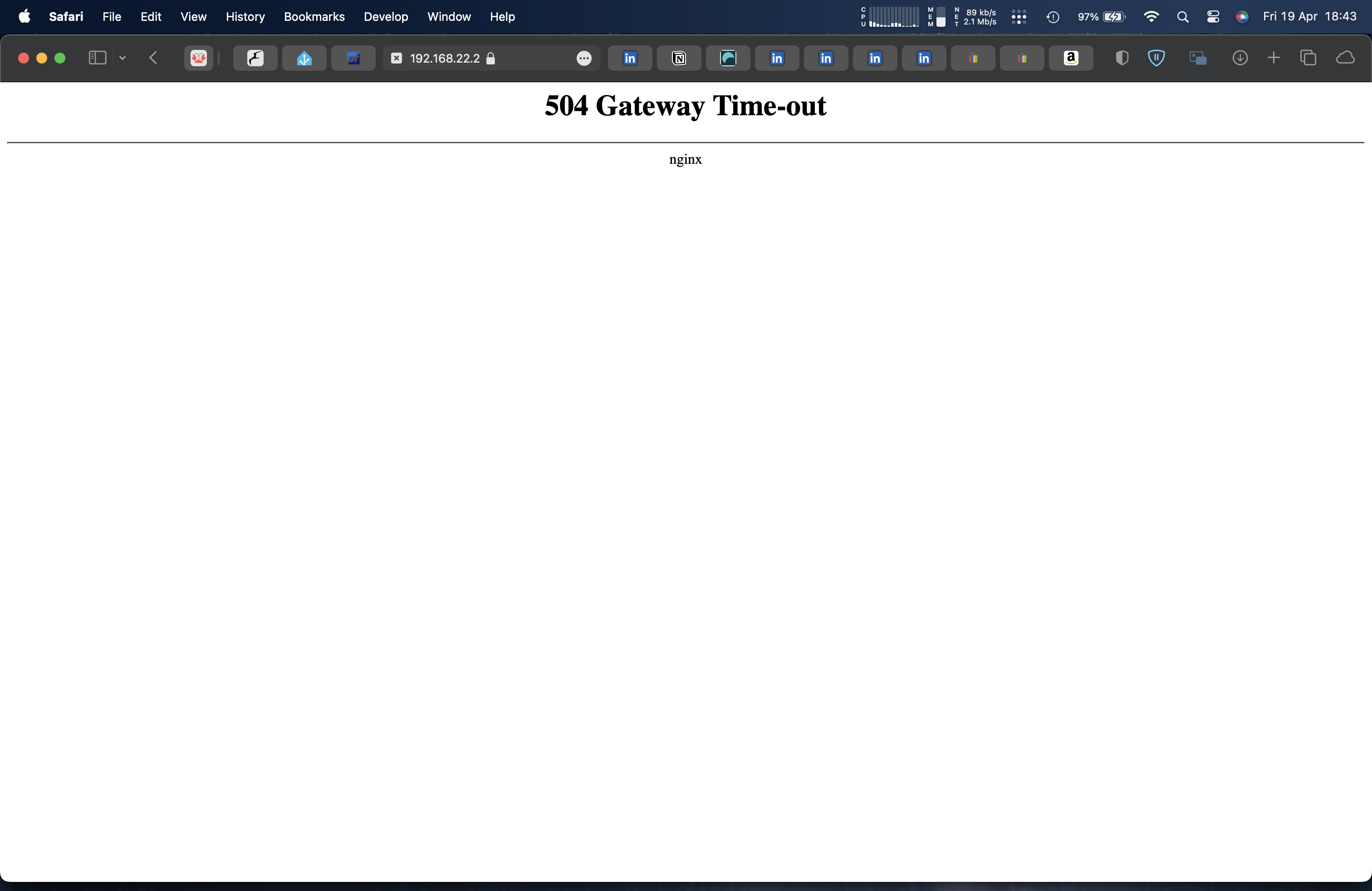

Would this script work to monitor the GUI's nginx instance & restart if necessary?
I'm trying to find out if "504 Gateway Time-out" actually appears in the log or is just displayed.
#!/bin/bash
NGINX_LOG="/var/log/nginx/error.log"
# Monitor NGINX error log for specific error messages
tail -n0 -F ${NGINX_LOG} | while read LINE; do
    if echo $LINE | grep -q "504 Gateway Time-out"; then
        echo "NGINX error detected: $LINE"
        echo "Restarting NGINX..."
        systemctl restart nginx
    fi
done
Its very occasionally but I want to avoid the GUI locking up like this:
366454024_Screenshot2024-04-19at18_43_55.thumb.png.9779f9c097467bd337aa9d433d7ae5c3.png
I hope you don't mean unraid?
If so: (/etc/rc.d/rc.nginx {check|start|stop|term|restart|reload|renew|update|port|status|upgrade|rotate})
I think it should work and "504" should be enough, here are a few additional parameters:
(just for starters - so that the script does not always restart nginx)

Yeah just the unraid GUI nginx instance locks up & becomes un reachable, but ping all ok &  all other sevices (shares, docker, VMs) are working and accessible.
It's rare but it's annoying when it does happen.
ok, then you must change "systemctl restart nginx" to "rc.nginx restart". Unraid do not use systemd.
/etc/rc.d/rc.nginx restart
And I think you should backup your settings and reinstall unraid... or have you already tried that?
Edited by Amane
