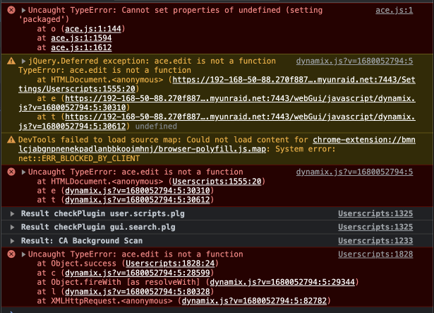

@Squid - For me at least, I get the following error on page load... (Chrome)
ace.js:1 Uncaught TypeError: Cannot set properties of undefined (setting 'packaged')
    at o (ace.js:1:144)
    at ace.js:1:1594
    at ace.js:1:1612
o @ ace.js:1
(anonymous) @ ace.js:1
dynamix.js?v=1680052794:5 jQuery.Deferred exception: ace.edit is not a function TypeError: ace.edit is not a function
    at HTMLDocument.<anonymous> (https://192-168-1-10.878757bd53f71ad14272183dbae65d47ceb4439a.myunraid.net/Settings/Userscripts:1218:20)
    at e (https://192-168-1-10.878757bd53f71ad14272183dbae65d47ceb4439a.myunraid.net/webGui/javascript/dynamix.js?v=1680052794:5:30310)
    at t (https://192-168-1-10.878757bd53f71ad14272183dbae65d47ceb4439a.myunraid.net/webGui/javascript/dynamix.js?v=1680052794:5:30612) undefined
E.Deferred.exceptionHook @ dynamix.js?v=1680052794:5
t @ dynamix.js?v=1680052794:5
setTimeout (async)
(anonymous) @ dynamix.js?v=1680052794:5
c @ dynamix.js?v=1680052794:5
fireWith @ dynamix.js?v=1680052794:5
fire @ dynamix.js?v=1680052794:5
ready @ dynamix.js?v=1680052794:5
$ @ dynamix.js?v=1680052794:5
dynamix.js?v=1680052794:5 Uncaught TypeError: ace.edit is not a function
    at HTMLDocument.<anonymous> (Userscripts:1218:20)
    at e (dynamix.js?v=1680052794:5:30310)
    at t (dynamix.js?v=1680052794:5:30612)
...and then when clicking on edit script...
Userscripts:1491 Uncaught TypeError: ace.edit is not a function
    at Object.success (Userscripts:1491:24)
    at c (dynamix.js?v=1680052794:5:28599)
    at Object.fireWith [as resolveWith] (dynamix.js?v=1680052794:5:29344)
    at l (dynamix.js?v=1680052794:5:80328)
    at XMLHttpRequest.<anonymous> (dynamix.js?v=1680052794:5:82782)
Hope this helps.

@SquidI'm experiencing the same as the others. I took a quick video of the issue.
Here is a video https://monosnap.com/file/QjtqsB9WAGEMEfny0zmHUrK0hXNZLe
And this is what is in the console:

Identical to me.  Trying to make arrangements with someone so I can TeamViewer into their system to see what is wrong.  IE: You can't fix what ain't broke

And that's how you replicate it.
Simple solution -> uninstall Connect (although LT / @ljm42 would probably yell at me for even suggesting that)
But now I have something to work on...

This is a connect issue, not a User Scripts issue.
Connect also breaks editing a file with Dynamix File Manager

Hi All - We have a fix and are publishing a Connect plugin update to fix it today. Thanks for letting us know.
Unraid Connect v2023.09.07.1147 has been released to remedy the conflict in the javascript causing the bug while editing.
